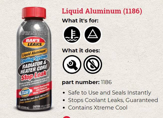

A small dose of a very mild stop leak still may be in order.
Not a fan of this either, but Bars Leaks has one product called liquid aluminum. It doesn't have the red powders in it that can plug things up. Used it a couple of times on different vehicles and it worked pretty well with out plugging things up.
You can get it at most auto part stores. I think it was about $8 for a 16 oz bottle. Didn't seem to do any harm.
