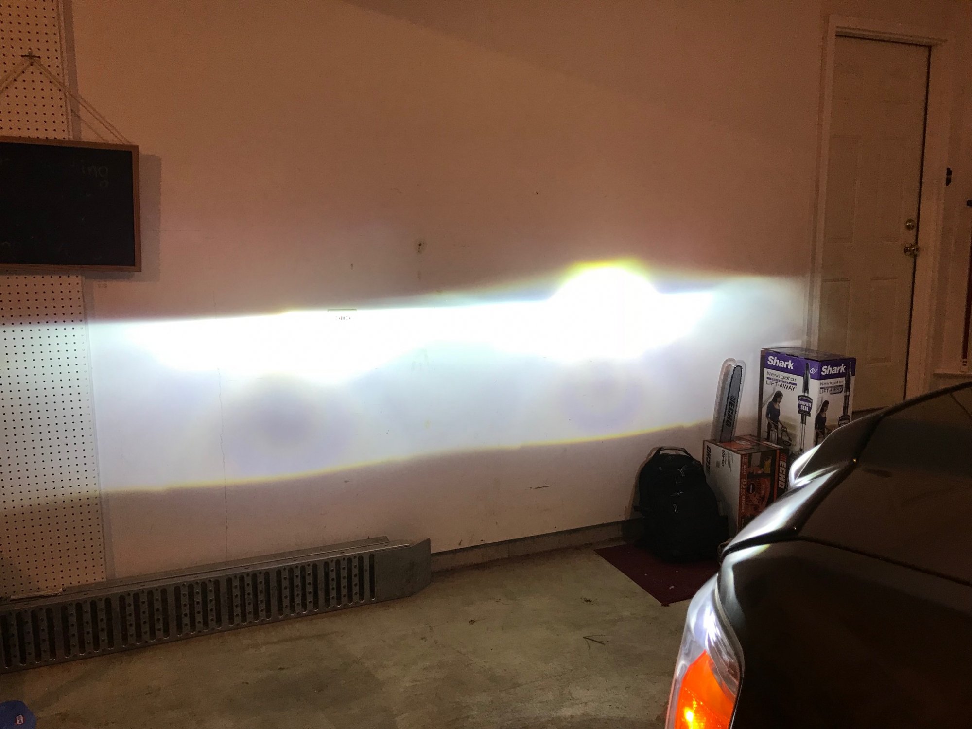

I'm fairly certain my passenger side stock projector bit the dust.  The hi beam solenoid no longer moves, my shutter looks like its stuck in the middle of high beam/low beam.  I tested power and I am getting voltage all the way to the solenoid plug but no movement from the solenoid motor.  I am not aware of how to repair this part short of replacing the whole headlight.
Cheapest solution to this is to purchase the Retro-quick projector kit from TRS and swap out both factory projects with new projectors.  I will have to purchase DS2 bulbs and igniters since I already have the rest of the TRS HID kit.
Has anyone used this kit?  Couldn't find much info and its significantly cheaper than new headlights or other projector styles.  Install looks straight forward.  Found a walk through of a FXR projector upgrade which appears to be similar.  You have to cut the back of the housing up but with a dremel it appears to be easy work.
Anyways just seeing if anyone has used this kit yet or if I am in uncharted waters. Picture below of the current beam pattern at "low beam." The yellow on the right side tells me the shutter shield is messing with the beam pattern.

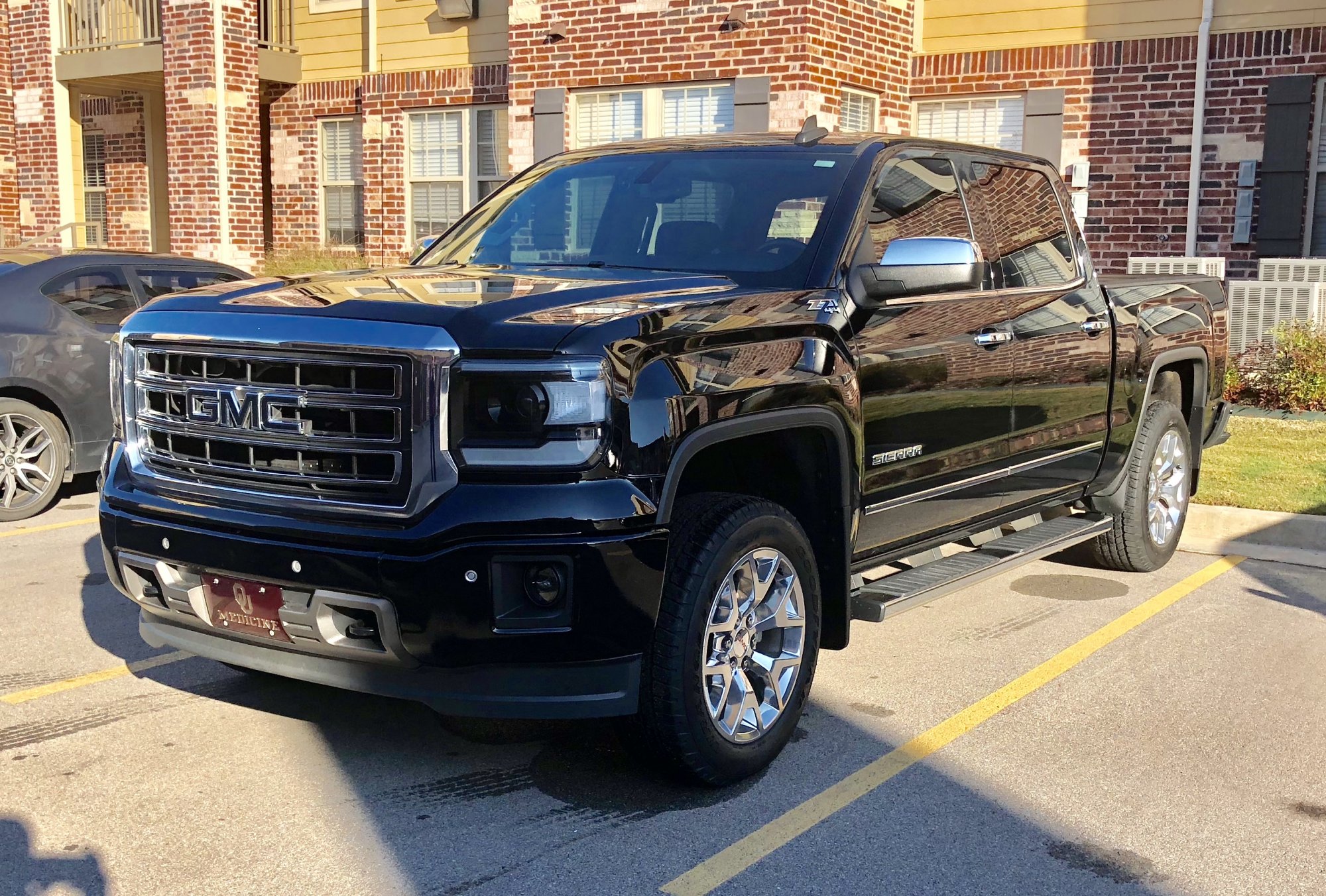

I had some experience and a TON of lessons learned on a previous headlight project in my Civic days that taught me to take my time on the silicone waterproofing.
As far as the igniters mine fit, its tight but I noticed you need to make sure the cord going into the igniters is twisted a certain direction in the housing so it has ample room (i forget which way).
I need to get some inside pics of the light distribution, but it was worth it. The diode dynamics switchboards are also a good option. I’m an ameteur painter but it turned out ok, definitely was a little cumbersome putting everything together. 3 months in without any leaks, fingers crossed it stays that way.
