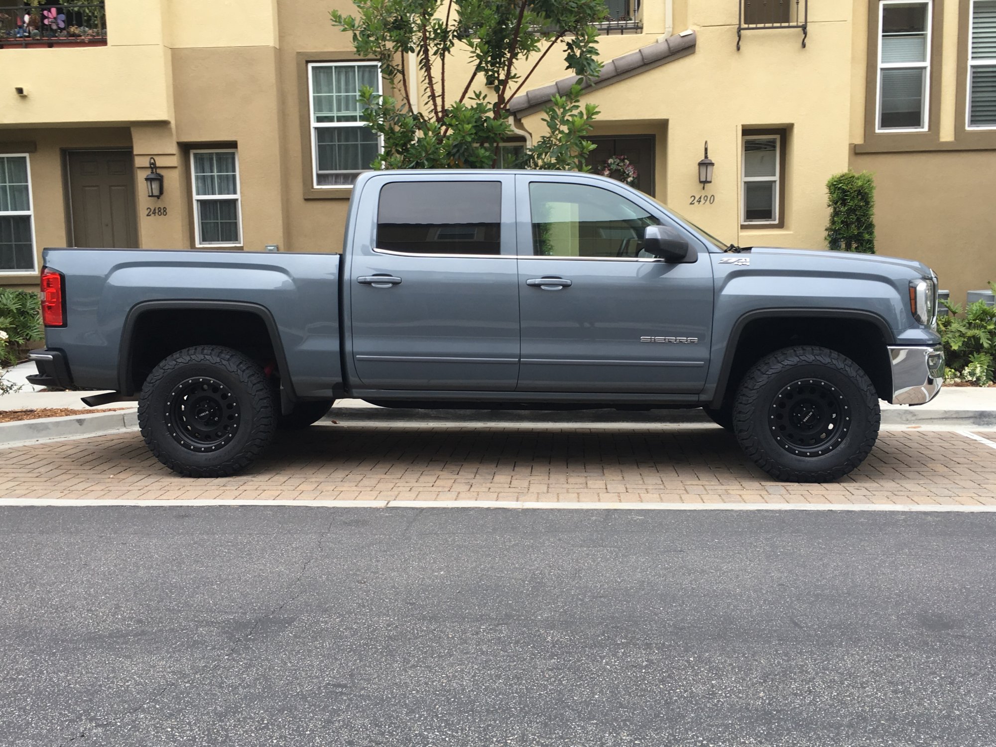

RC 2.5” Lift Leveling Kit, 17x8.5+0mm Method, 285x70x17” KO2 Install. ‘17 Sierra z71 CC
Been waiting for a while to install this stuff. Had the Baja kits UCA on order, but couldn’t wait any longer to install since I’ve been running on the spare.
Parts installed:
17x8.5” 0mm offset Method MR307 Matte Black
BF Goodrich KO2 LT285x70x17 121/118R
Rough Country 2.5” Lift Leveing Kit

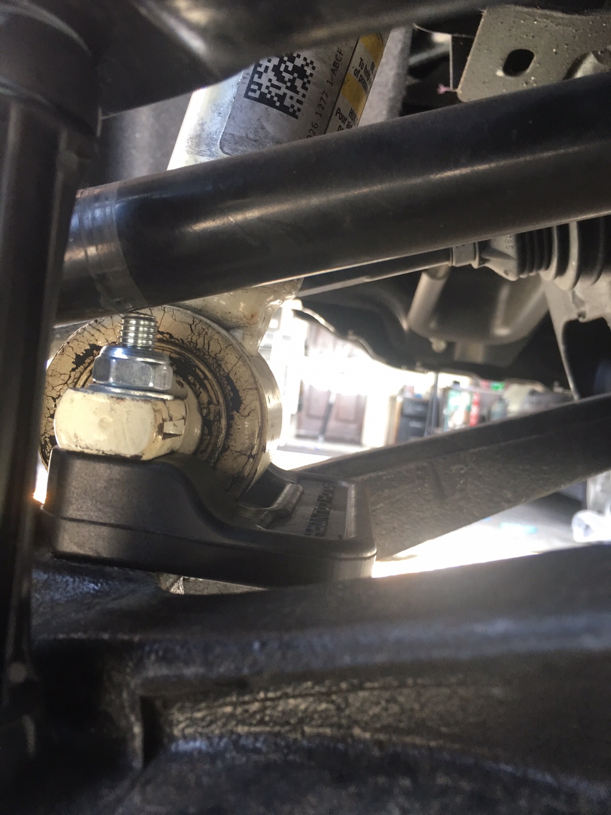

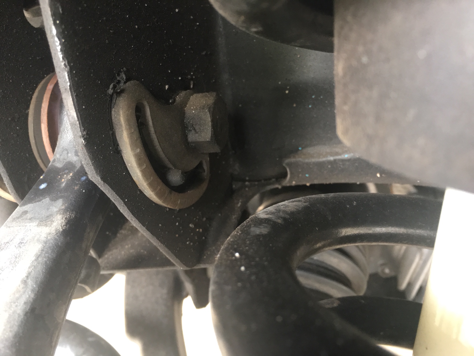

Here’s the angle of the factory UCA ball joint. Not sure if that is pretty extreme, but I did end up ordering a cognito UCA with the sealed ball joint instead of the uniball. Went with the ball joint since I am constantly at the beach. Necessary?

Today I was supposed to just install the Cognito UCA’s, but ran into issues and pretty much had to redo the 2.5” Lift level kit.

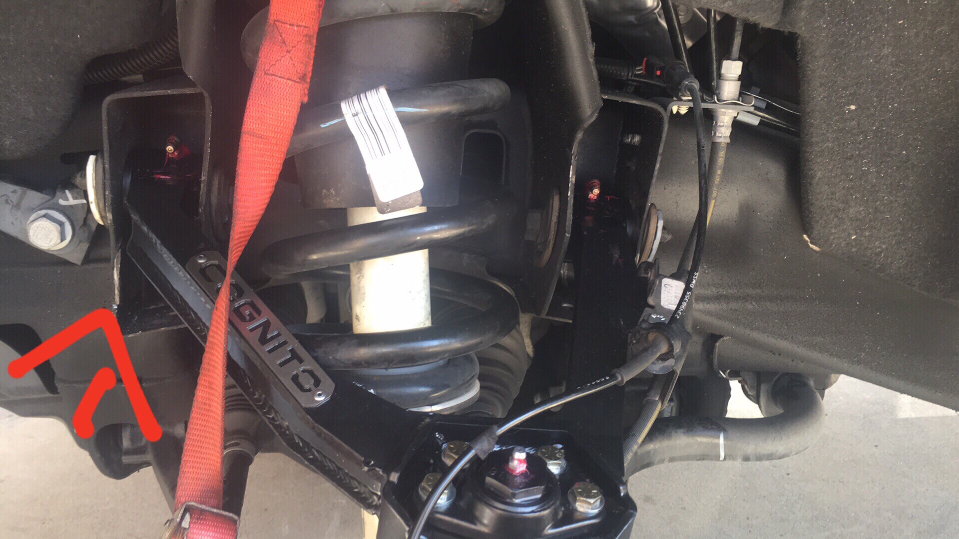

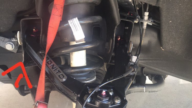

As you can see this bolt is rubbing against the half-shaft. This is the orientation of the stock bolt and in the video I watched of the level kit. Flipping it over gave the proper clearance.

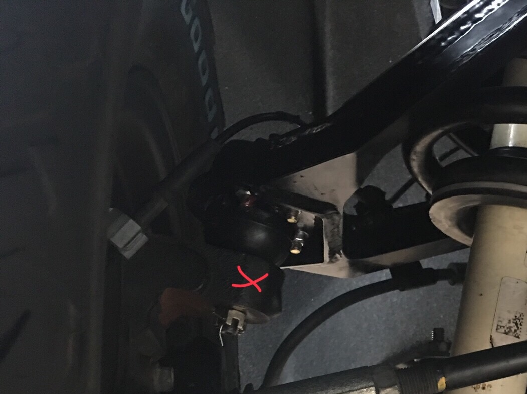

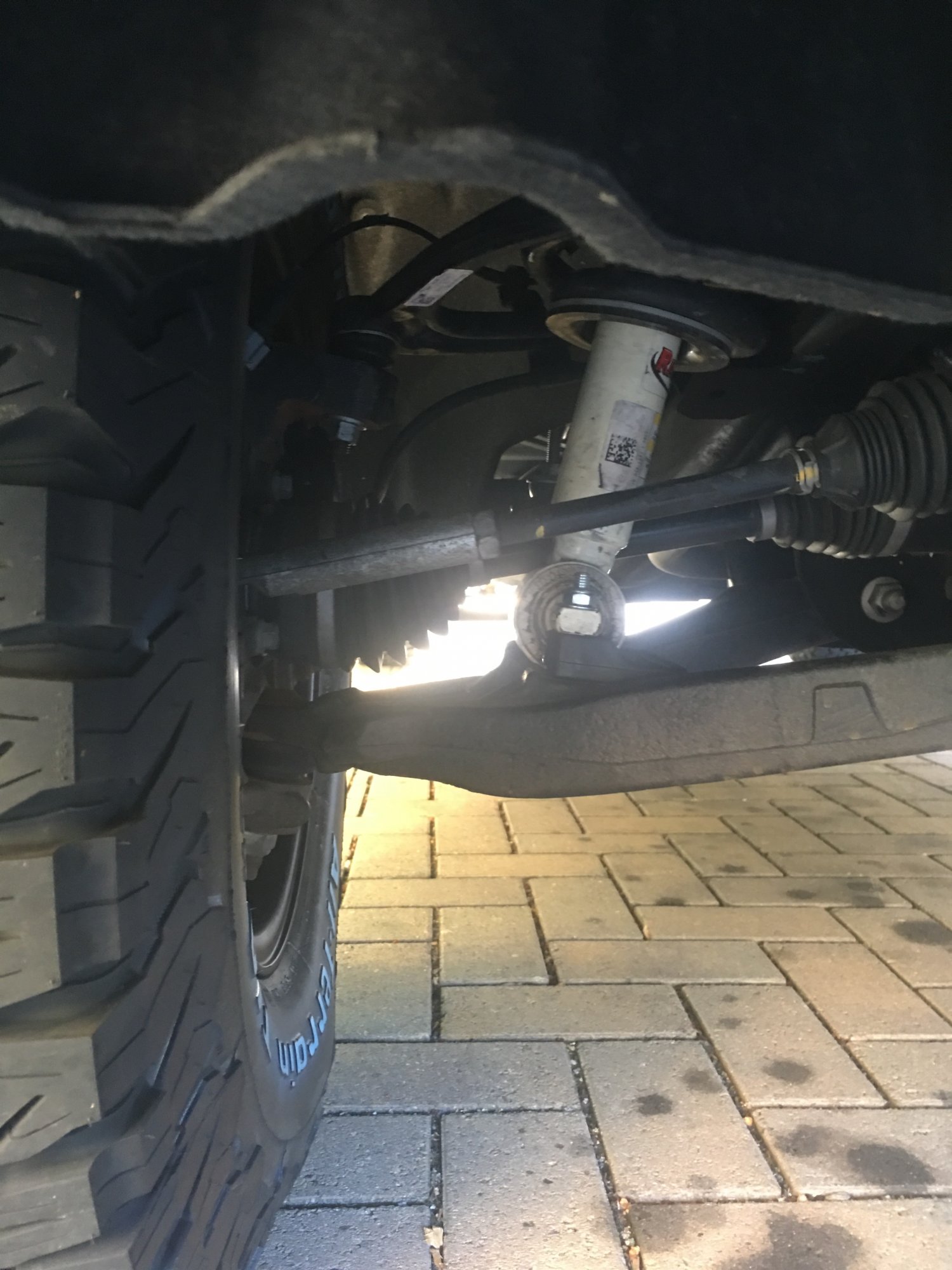

Remove the nut and hit the X with the metal hammer to break free the ball joint.
I marked the locations of the alignment guides before removing. Alignment seems to be the same as with the lift kit installed. Forgot to take a pic, but the bottom of the tapered hole for the ball joint bolt will need to be expanded for the new ball joint bolt to fit. This is where the 1/2” drill bit will be used to expand the hole.

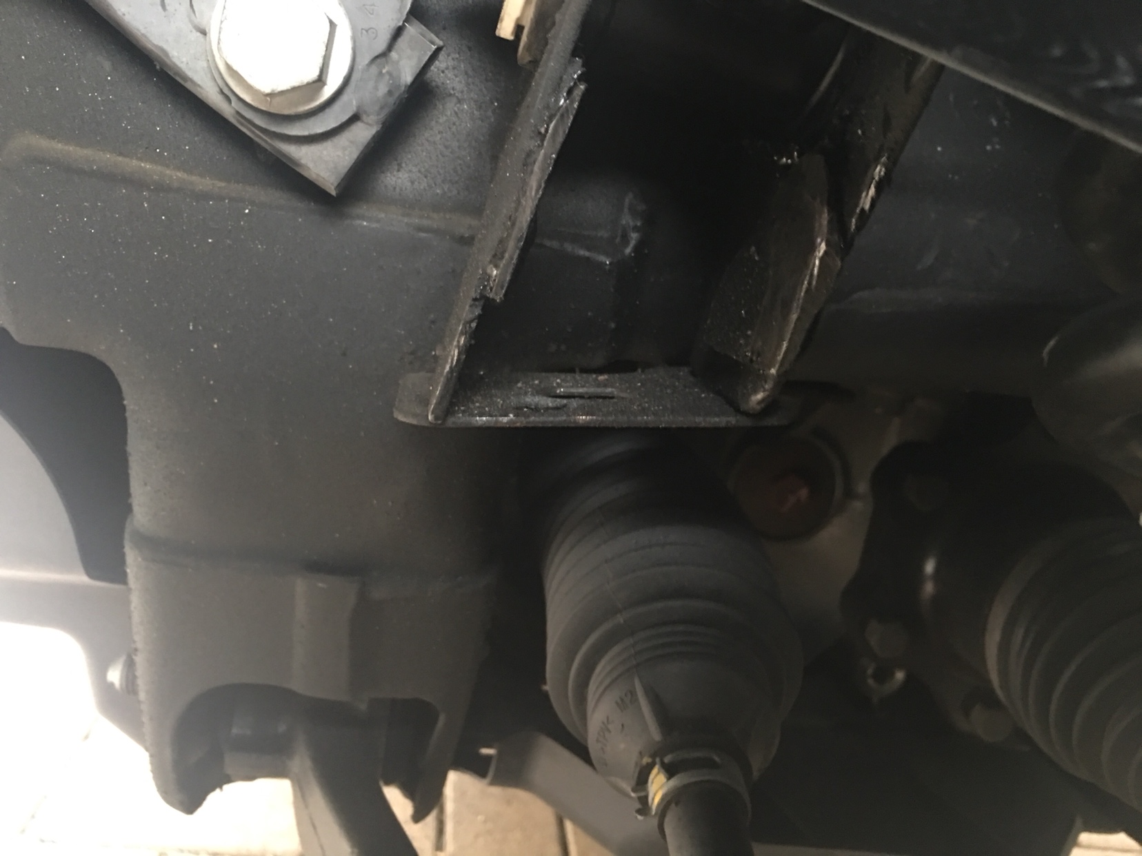

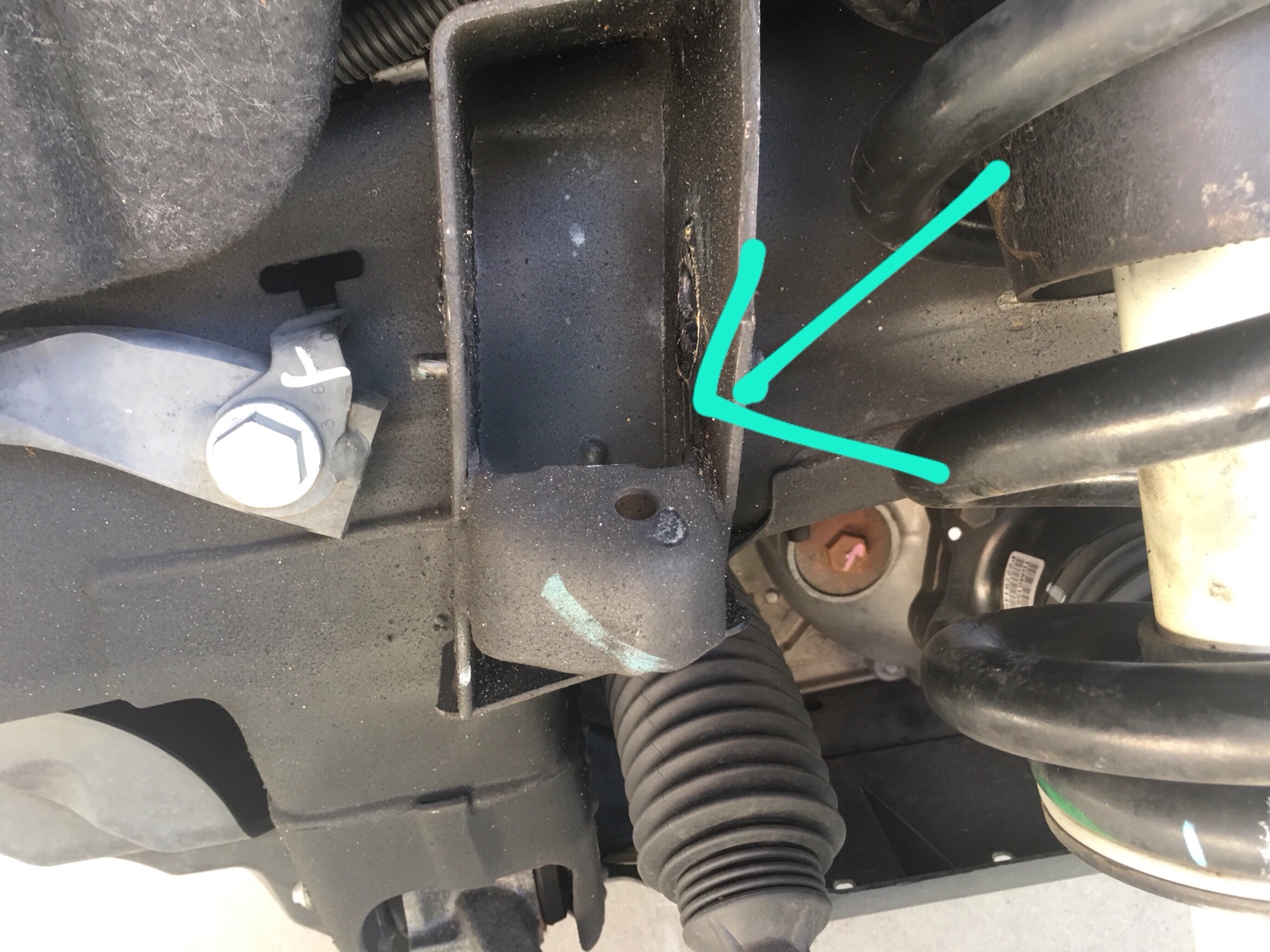

This “service perch” or bump stop will need to be cut off.

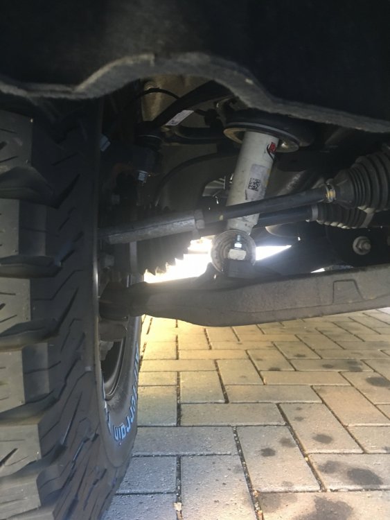

Torque alignment bolts to 90ftlbs, ball joint to no more than 50ft lbs. align sights and insert cotter pin. Then grease everything up. 2-3 hours is just about right to do the install.
Some things I noticed is that with the stock control arm, you can maybe move it up and down ~2 inches before it starts to bind and there is a lot of resistance. With the Aftermarket control arm, the resistance is even throughout the whole travel length. The ride is also pretty much back to stock feel. To me it was definitely worth the cost ~$600 after shipping and taxes for the piece of mind and better feel. I’ll try to get in line for an alignment tomorrow to see how everything is.
The squeaking noise I was experiencing on the passenger side has also gone away. I think the noise was coming from the OEM upper control arm. The clunking noise on the driver side also went away. The steering ball joint seemed really easy to break free and maybe wasn’t seated completely. I also added more grease while I was at it.
