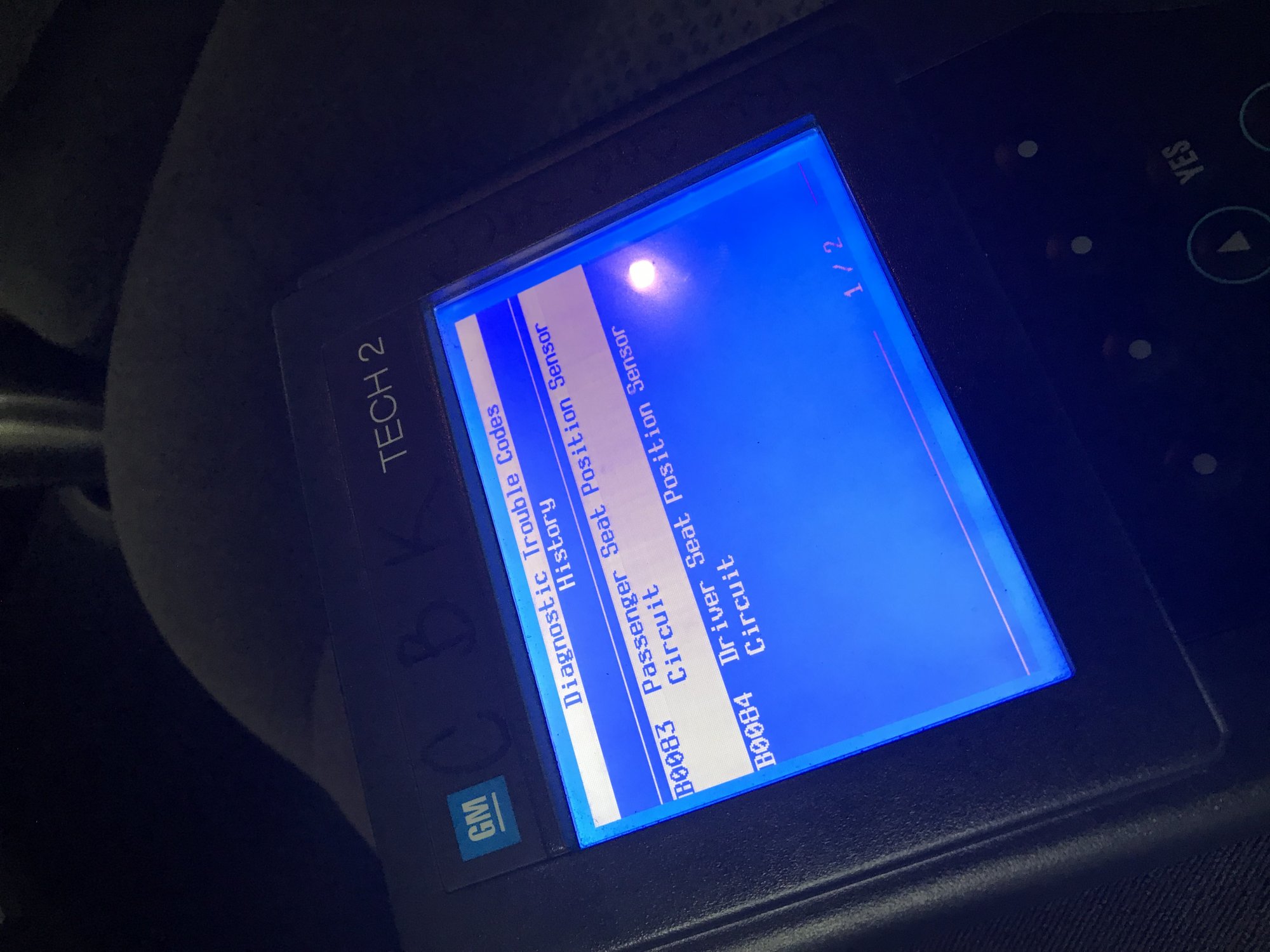

All is good and dialed in, start driving home and notice the airbag light is on....then off. So I kept driving. A moment later it’s back on. So I make a u turn and head back. They looked and said the truck is throwing B0083 and B0084 codes. Seat position sensors for both front seats. Tech and I Looked under it and  They seemed to be fully connected.
Dr google also found that some have said those codes are front end collision sensor faults. The scan tool brought back seat position info though for a 2006. I’ll attach a picture.
I have yet yet to crawl under the truck to see if something is off but is there anything I could/should look for? Can an alignment screw up airbag sensors? I’ve heard of the clockspring but seat position sensors?!

B0083 and B0084 set only for the impact sensors.  Did the codes they pull have symptoms as well?
Quote
DTC B0083 00
Left Front Impact Sensor
DTC B0083 0F
Left Front Impact Sensor Erratic
DTC B0083 39
Left Front Impact Sensor Internal Electronic Failure
DTC B0083 3A
Left Front Impact Sensor Incorrect Component Installed
DTC B0083 71
Left Front Impact Sensor Invalid Serial Data Received
DTC B0084 00
Right Front Impact Sensor
DTC B0084 0F
Right Front Impact Sensor Erratic
DTC B0084 39
Right Front Impact Sensor Internal Electronic Failure
DTC B0084 3A
Right Front Impact Sensor Incorrect Component Installed
DTC B0084 71
Right Front Impact Sensor Invalid Serial Data Received
