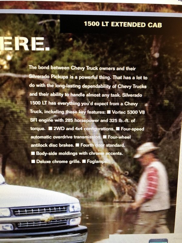

Well I finally found proof that I am not crazy. I thought for sure the 2000-2003s had rear discs and sure enough they did on half ton LT's [as well as the 2500/3500s]. Here's a brochure page clip from 2002 on that particular model. Also found someone selling a rear axle with discs on it from 2003 on FB in a group I follow. Now the hard part will be finding a 100k mileage or so truck when it's time.
Why do you think 4 wheel discs are necessary? The rear drum brakes are a better setup IMO. They work just as well and you get a parking  brake that will actually hold the truck.
Don't think....I know. I am wanting to be able to do my brakes myself and don't need emergency brakes as much as I do ease of changing the rotors and pads myself. I live in flatland Texas and rarely park on an incline of any kind that the parking pin won't hold. When it comes to stopping power hauling a trailer, nothing beats a disc.
