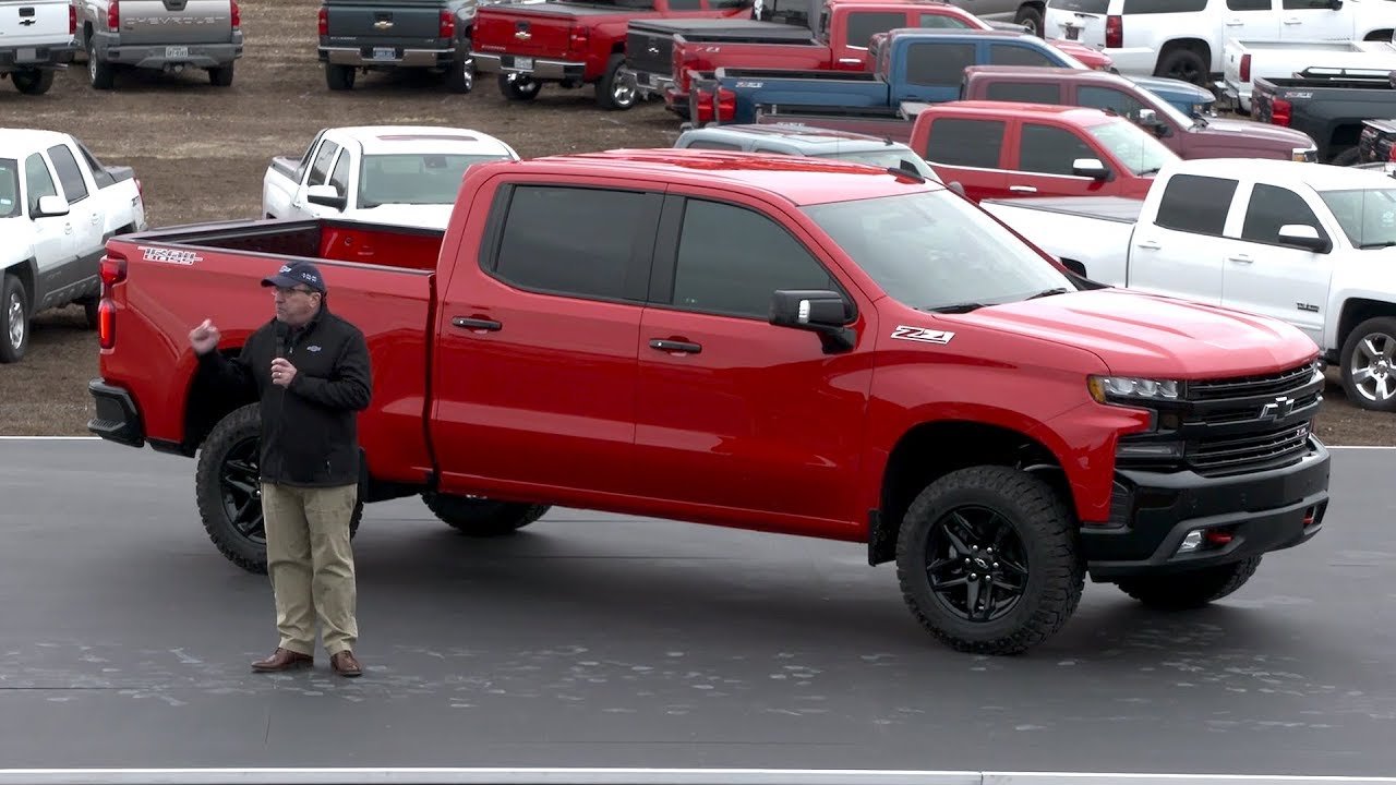

The Trail Boss that debuted in December & at the Detroit Auto show had the task lights in the mirrors.maxresdefault.thumb.jpg.a80c922dfa397b4e9546b43e2657bed7.jpg
i know but 80% of the LT's what I viewed online past 2 weeks don't have em. I was wondering what option that I has to add in order to get those. Chvrolet shows preproduction show trucks but most of the time of when this is shown trim package option groups isn't finalized.
