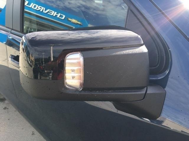

What exactly does the Advanced Trailering Package include?  3.42 rear end?  I noticed the side mirrors have an outside turn single indicator or something?  it appears the mirrors are the same size as regular.. but it just has some sort of light on the outside. Is there anything else?

As for the mirror, yes, that is a light, work light of sorts that is integrated on certain trim levels.

The mirrors with the front facing cargo/task lamps are included in the Safety I package.  The mirrors that go on are basically the DLF power heated mirror, but with LTZ features such as the task light and the blind spot light in the glass.
The package to get the mirror in the picture above:
Quote
PQB Safety Package , includes (UD5) Front and Rear Park Assist, (UKC) Lane Change Alert with Side Blind Zone Alert and (UFG) Rear Cross Traffic Alert
1 - Requires (PCL) Convenience Package. 2WD models include (V76) front recovery hooks.
2 - 2WD models include (V76) front recovery hooks. Included with (PDF) LTZ Plus Package, (PDK) LTZ Premium Package or (PDL) LTZ Texas Edition.

You can get the power folding mirrors on Trail Boss if you opt for the Safety Package as Newdude stated above.
The Trail Boss is an 2LT
You can also Get the power folding mirrors on an 1LT.... again by adding the Safety Package.
3 hours ago, GMC-AT said:
those mirrors do power fold correct?
3 hours ago, Sierra Dan said:
Yes
No power fold.  Its the DLF power/heated mirror with LTZ features as mentioned above in my other post.  Power fold is not one of those features.  Just the blind spot indicator glass, and the task light on the front.  Can confirm from the LT I drove with the safety pack last night.  Only mirror buttons on the door panel were for adjusting the mirrors.
