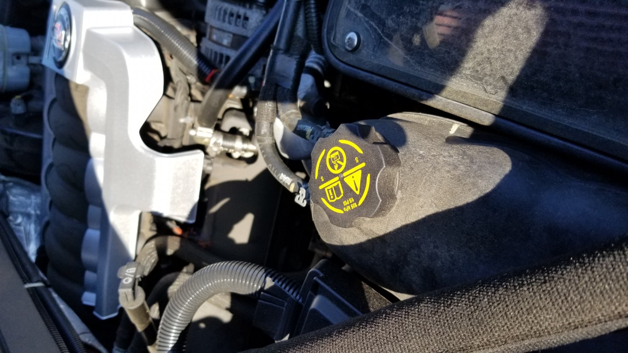

There are cheaper ones than that. But i would say yes, if you can rent it, go for it.  Make sure its cold. Remove the cap, hook up adapter and pressure tester  Pump away till you get to 15 psi max. Look at the pic, it says it on the cap. And then look for leaks. After you find the leak, release pressure. Then remove the tester.
