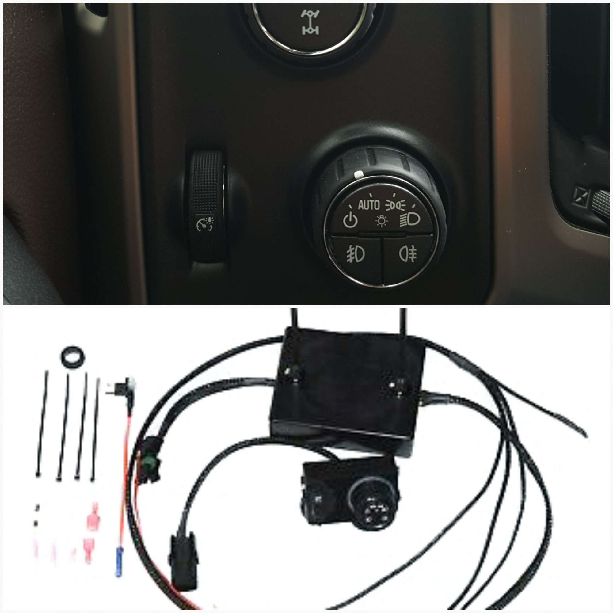

Go one step further and give it a factory switch so it looks like this. This is a GM part. The bottom right button operates the light bar.
I have a light bar on the front wired into that switch. I have two cubes in the back that I wired to automatically come on with my reverse lighting as well. All of my off-road LED lights are from Rough Country. Rough Country off-road lighting is a great quality alternative to a high-end brand like Rigid. The best thing about RCX is that they have a "scratch and dent" eBay profile that sells their products drastically marked down. (I'll post a link to their profile below.) I bought all of mine from their scratch and dent sales, and I can't find anything wrong with them aesthetically.

23 hours ago, Will S said:
Will that switch work with your dimmer switch to turn on and off the light bar if wired through modules
it will dim with the interior lights, you cannot dim the exterior grille mounted lights with it.
the switch is just a switch lead for a relay, can't wire the lights in line through the switch.
