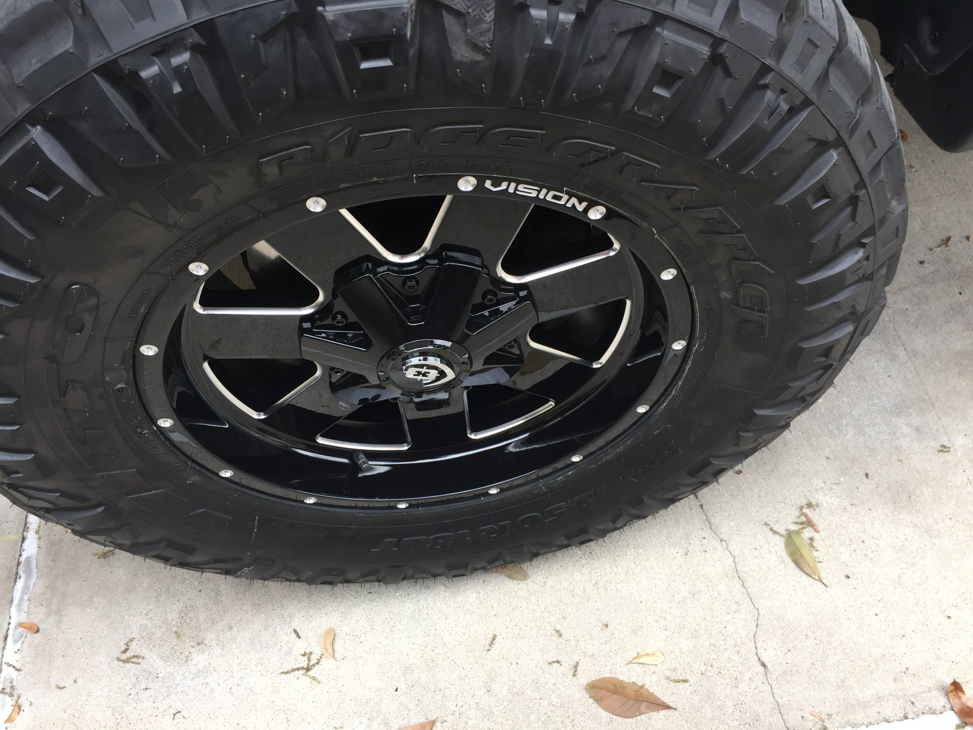

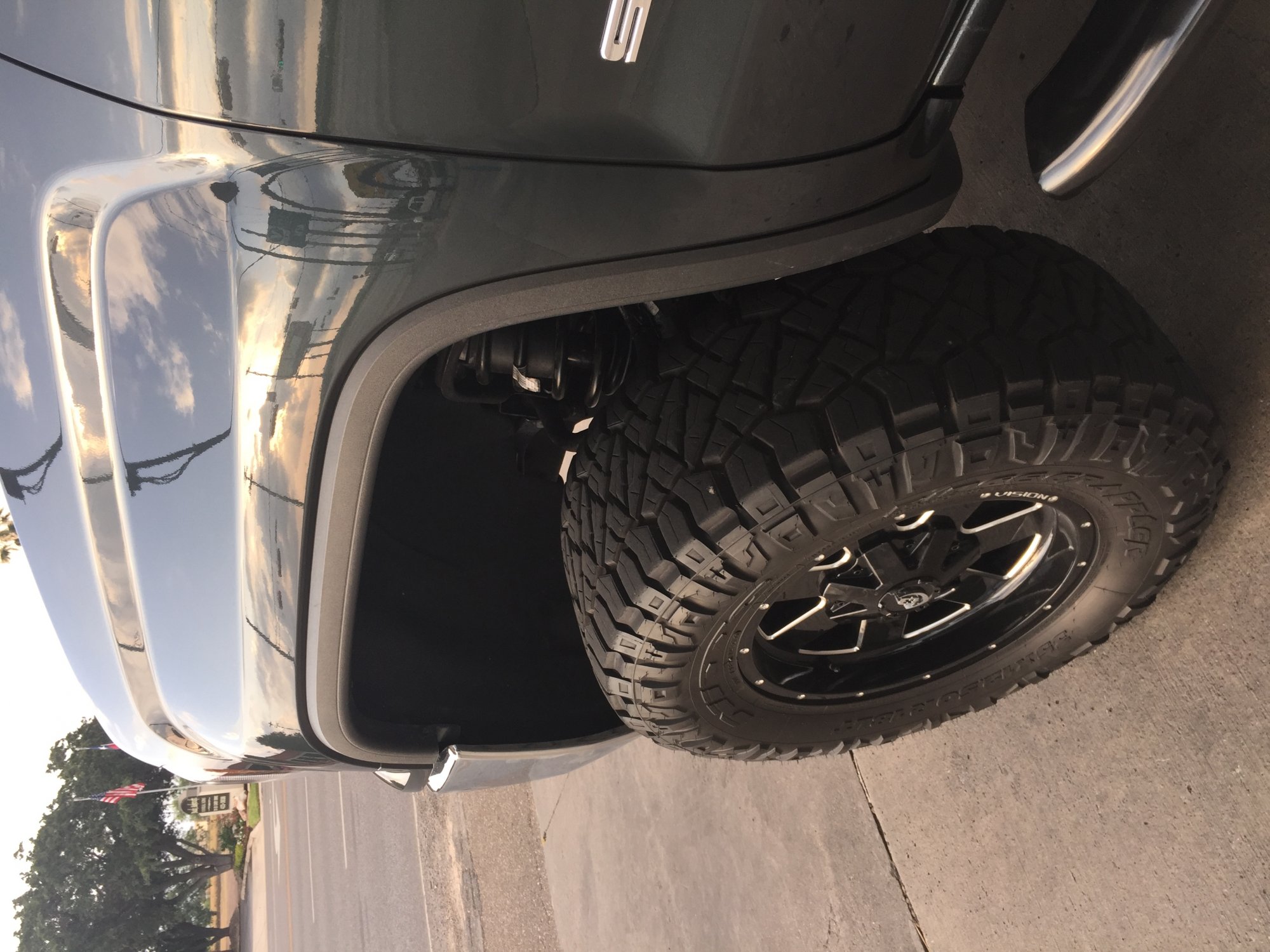

I’ve been running e rated tires since a teenager on mostly SUV’s and on trucks. The stock tires (which you’ll notice throughout the forums) are garbage but some folks really don’t care and just keep same tire that came with their vehicle, others (including myself) would rather have a much more durable tire, considering it’s a truck. Vehicles suspensions and sound deadening material have come a long way and E rated tires have been found to ride noticeably smoother than they used to especially since one of the first thing people do to their new Truck or new to them is modify the Truck and SUV’s.
I run (34”) Nitto Ridge Grapplers, because I like the excellent ride quality, looks extremely durable and because that’s the size tire that better fills the void. I chose these Nitto’s cause they’re actually designed to run smoother and quieter than previous generation E rated tires.
If you’ve been happy with running (P) standard passenger tires, let the tire store know BUT if you want a tire that’s much more durable and protects against rips/cuts/punctures and excellent towing capabilities then you’re better off keeping your new E rated tires and just get used to them or choose a better quality E rated tire like Nitto, Toyo, BFG or a great highway e rated Michelin just to name a few. Remember, when it comes to tires, you get what you pay for.
Here’s my setup which works great for me. Excellent ride quality!
