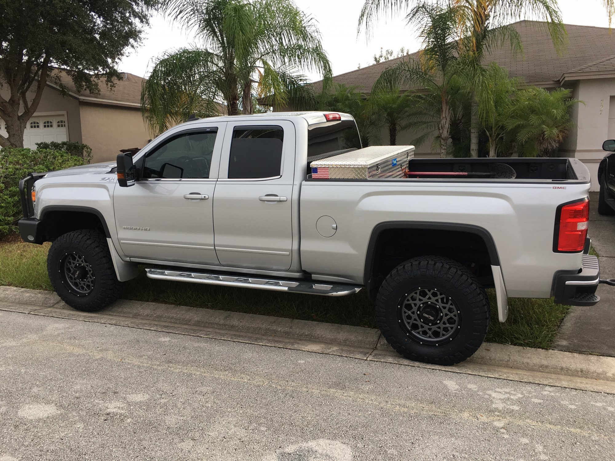

On my 2500hd, these 285 75 18's needed aftermarket torsion bar keys to clear. 35 inch tire, 18 x 9 wheel, +12 offset, like 5.5 inches of backspacing.
