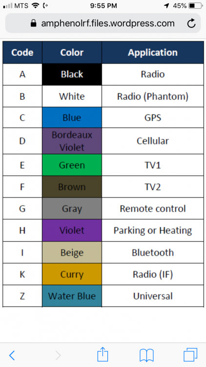

i also found rhis online about farka connector colors. It may mean nothing but the black does jive with that being am/fm.
I wonder if I have “Bordeaux Violet” And “Brown” which are “cellular”and “TV2 “respectively. Which could also make sense and these are for the onstar/WiFi and my backup camera... again, respectively.
I’m loosing hope :(

I don't have access to the GM parts catalog but your system may use a different antenna an less leads.
You have seen shark fin antennas that have fewer leads that multipurpose fewer connectors? If that's the case, some sort of Y adapter must be used to split the leads or something. Couldn't find anything online but is it possible that there are few to no differences in today's Sat/GPS/Cell antennas? I have seen pics of the backside of some shark fins online with 3 wires and there's not a lot of space in in that thing to begin with. I'm almost tempted to just try plugging in the purple connector to my Sirius and see what happens but I don't think I can get that fakra connector off without destroying it. I do have an extension cable in transit that might allow me to test this. I couldn't careless if OnStar goes away, I'll never use it. Have already thought about switching out that mirror in favor of an electrochromatic version to replace my "flip" mirror.
