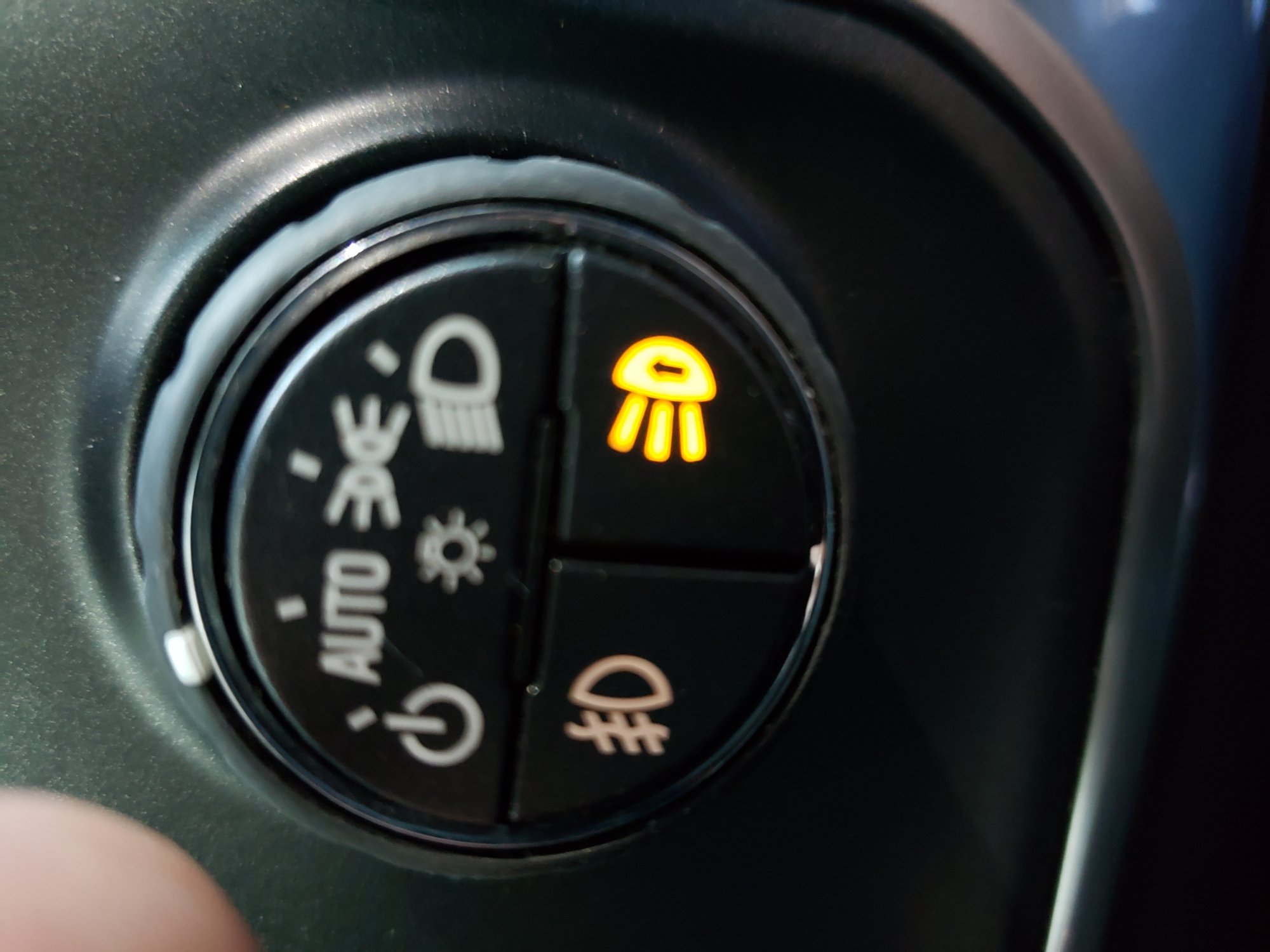

Thinking about doing the rough country 30” behind the grille and maybe one in the dead space between the tow hooks (2014 Sierra) anybody done this and have any pictures and tips/tricks? What switch location cause im trying to avoid drilling at all cost.
Here is an idea for a switch that that requires no drilling & looks stock. Since yours is a 014 it requires the extra relay and wiring.
You can take out one of the 12v sockets in the center console and replace it with your switch. I have my train horn button there.
