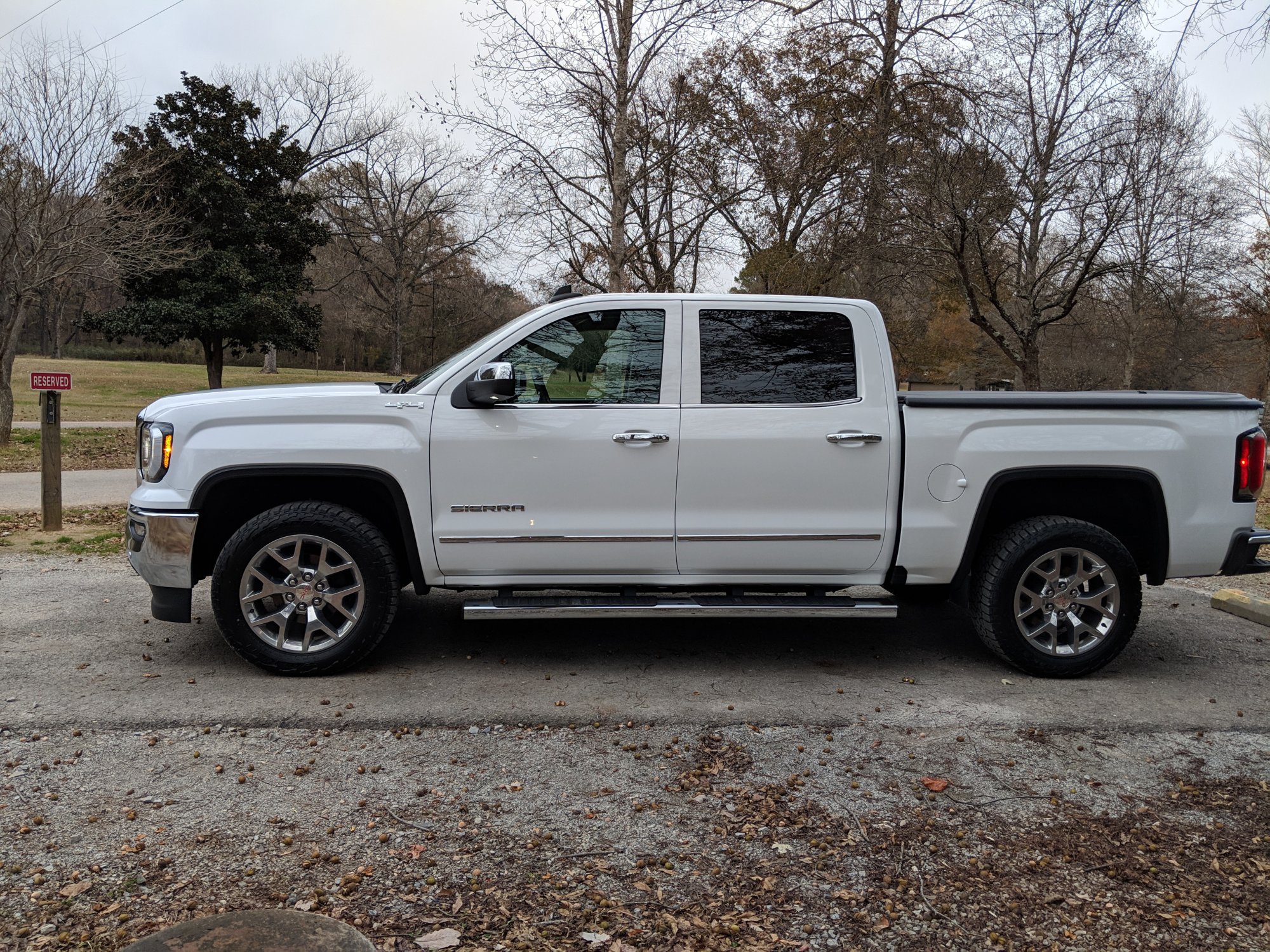

So with those being xl I assume you have the 275/55/20.
Does your truck have a level? If not could I see a couple more pictures of your truck detailing how those tires look without a level?
I really want the 275/60/20 but I don’t want to level my truck. So if those won’t fit I’ll suffice for the 275/55/20 but I want to see how it looks first.

No level. I had 275 60r20 on the 15 with the Bilstein's on the top setting. I got a little fender liner rub in reverse at full lock. A zip tie helped that.
So your tires aren't actualy 275/55/20? I never saw an XL option for the 275/60/20
You don't consider bilsteins at their highest setting a level?? I'm leery of the bilsteins or any level as i don't want to affect the geometry of the front suspension. I'm more in favor of keeping the parts from wearing sooner as well as avoiding any negative ride affects.
also my truck is an 18, I'm not sure i can level the truck and still fit 275/60/20

Okay A little clarification here my 2015 that I just trade it in for the 2018 had to Bilstein 5100 at the top setting and I was running 275 60 R20 s. Yes that was a level. The picture you are saying is currently my 2018 with no level stock tire size Falken wildpeak 275 55 R20 XL. The site is restricting me on picture size so if you want to p.m. me a contact information I can send you some more pictures but my 2015 with the 5100 and the 275 60 R20 s.
