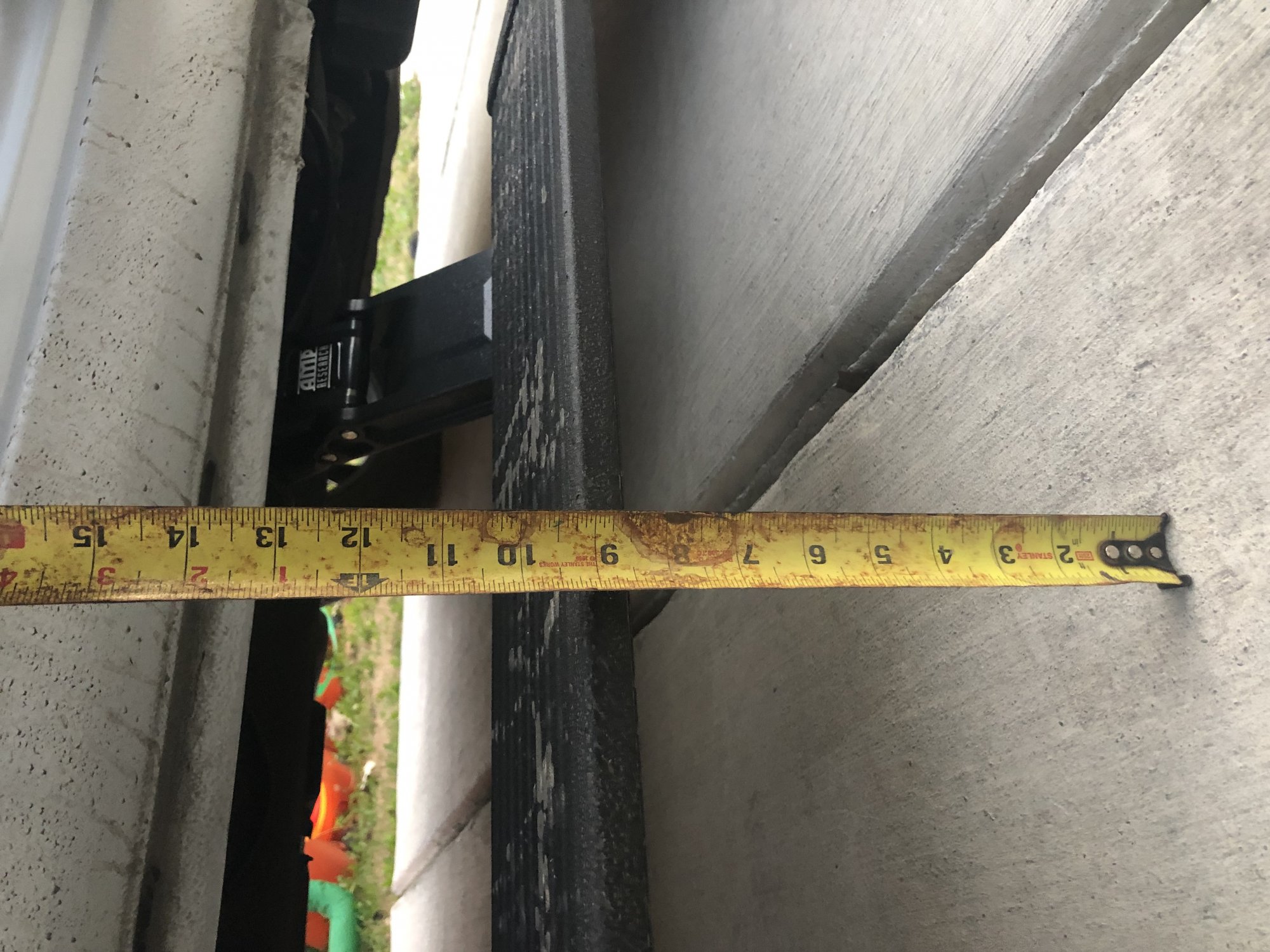

Not sure why pic is sideways but that’s the height of the steps when door is opened on my 2019 LT Z71. From the floor board to the ground it’s 23”.
my 2014 LT is 22” from the floor board to the ground and are 9” to the ground as well.
They work well considering my kiddos are all under 5’ tall and have to jump into the truck.
