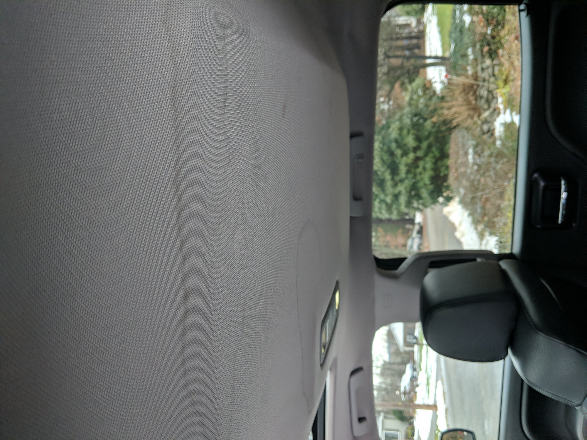

BUDMANZ71 Posted November 21, 2018 Posted November 21, 2018 I brought my truck to the dealer and they diagnosed the leak as the third break light. I brought it home and put some rtv sealant on it and put it all back together. Came out after some rain about a week later and it still leaked. Could it be the sunroof? I checked the drains and water leaked out as it should behind the front tires. It seems a little far forward for it to be the third break light. I just took it off again and re sealed it and put some clear silicone on the outside of it. Any help would be appreciated. Thanks.

BUDMANZ71 Posted December 2, 2018 Author Posted December 2, 2018 Well after re sealing the brake light and putting some clear rtv on the outside I brought it through a touchless wash and we had heavy rains with no leaks....heres to hoping it's fixed.
Bordo3k Posted December 4, 2018 Posted December 4, 2018 my 2014 Sierra was taking in water- headliner was soaked around the part of the roof where the onstar and sunroof buttons are. Research and an auto body expert both told me it was the shark fin XM antenna.They called the dealer next door and they confirmed that it is a continuing issue they see all the time. The seal gets damged when the vehicle goes through a car wash with brushes. Tried RTV clear silicone but did not fix the problem. Finally paid the money and had the auto body shop replace the shark fin. They reinforced it with some kind of tape (buttle tape or something? Cant remember) in hopes that it may help prevent another damage. They showed me how the seal was all busted up and they showed me the bracket that held the shark fin on- it was very corroded. Apparently if left unfixed it could possibly short out your display screen and other electronics. I think 250 in parts and labor was pretty good to get it fixed right. I took it to Monticello Auto Body in Monticello MN. The Chevy dealership wanted to charge me double.
BUDMANZ71 Posted December 4, 2018 Author Posted December 4, 2018 They originally replaced the shark fin and then when I brought it back again they said the third brake light. But my extended warranty does not cover the third brake light.

mbowen89 Posted December 19, 2018 Posted December 19, 2018 Pretty sure my third brake light was leaking, you can see water in it. I removed it and could pour some water out. It has a very thin foam seal. It was completely compressed and flat along the top, and dirty, obviously water had been leaking down through the top. I put a bead of RTV over foam and I hope that fixes it permanently.
BUDMANZ71 Posted December 19, 2018 Author Posted December 19, 2018 That is exactly what I would expect to see when the third break light was leaking. This has to be my sunroof. Thanks for the reply and pictures
