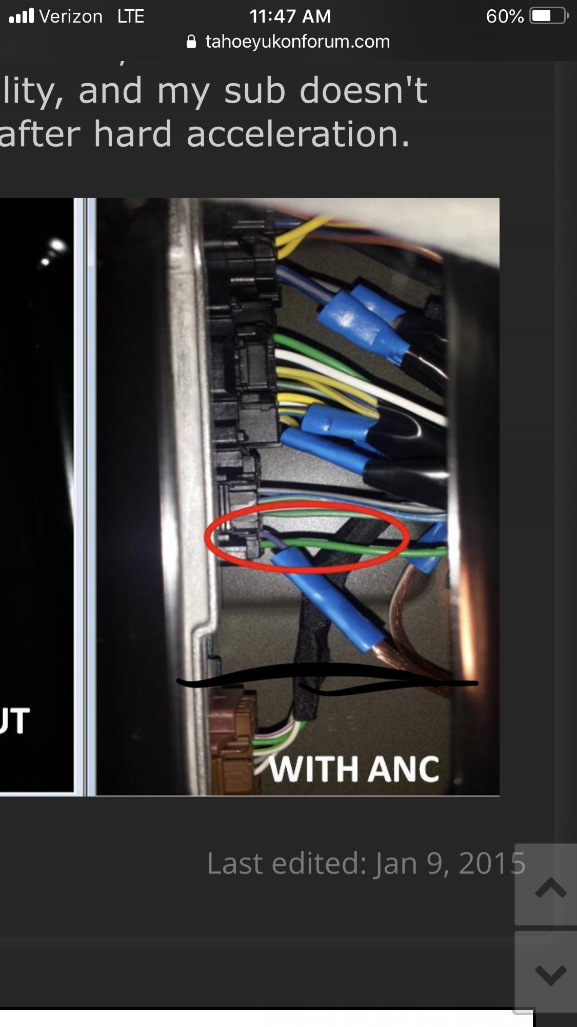

Hey, if you do have ANC, you will need to disable the ANC so it doesn't send your JL into freak mode!
I don't think so.  I'll double check but if I do, I know about the ANC delete mod.  I think it's the blue/purple wire in the drivers side rear door harness.  Just clip the wire and tape the leads and you're good.
Yep, I just put a male/female connector while I was there if I ever wanted to reconnect it which I don’t because the Bose sub is horrible. This is another place on the back behind the seat.
Is that the factory amp?  What are those gold wires (look like speaker wires) with the blue leads?  Tell me what you got going on here.

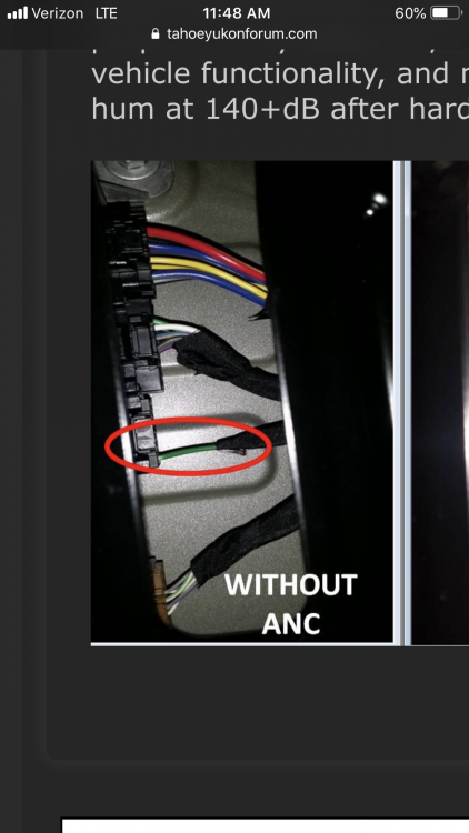

I believe so, I actually did mine in the door sill but strangely it was in the passenger side. The picture is one that someone else posted and it does look like they tapped off of it but the color wire is right. Not sure if they were just showing where it plugs in. Here is a pic without ANC. I save pics for future digging ?
