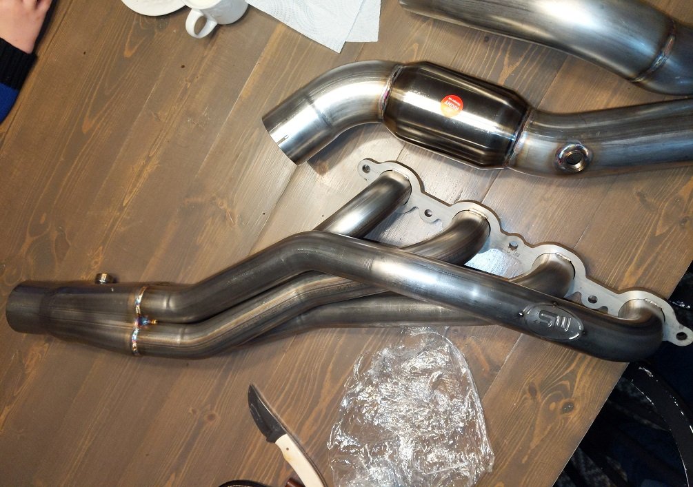

Stainless Works stuff showed up the other day. Has anybody used these headers on a RCSB? I'll be installing them next week. I noticed they sent 1 O2 sensor extension instead of 2, I guess I'll email them and ask if I only need 1.

I spoke with the guys at stainless works before I ordered them. I do have a regular cab, the issue isn't with the headers, it's how far the x pipe goes back. I can't purchase a true bolt on exhaust that will match up to it. I'll make something work, it should all be on next week.
