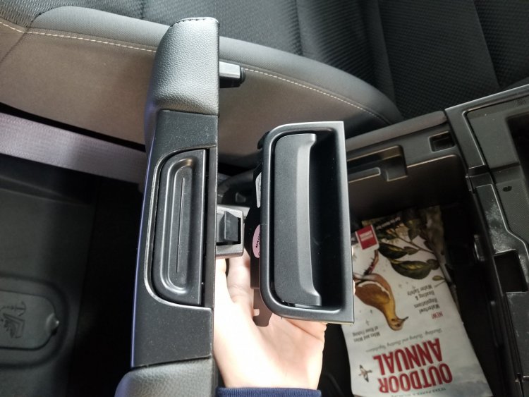

Broke center console latch, help
I tried pulling stuff off to get to the latch but i just dont know where to start. Cant find a 14+ truck video on it. Anyone know how to get to the latch to replace it? I ordered an oem. 20181203_104750.thumb.jpg.91e90a75e8aa3aa0b0db763d1c1a00ac.jpg

You have to pry the hard plastic bottom "away" from the cushioned top. I went to Harbor Freight tools and bought a set of plastic trim removal tools. I replaced the black latch in my LTZ with a chrome version. Just find a place where you can insert on of the tools, and then start carefully working your way away around the perimeter.
I got the latch thru the mail and its the worng part. Im confused, when ordering thru gm parts it asks to double check by putting info of truck. I did and made sure to order the correct part but its way too big? I cant seem to find the correct oem part number. 2016 gmc sierra 1500 sle rcsb 5.3 nonflex.. part number i got is gm#22792217
Call your local GM dealer and speak with someone in the parts department. Be prepared to provide your VIN and they will give you the correct part #
