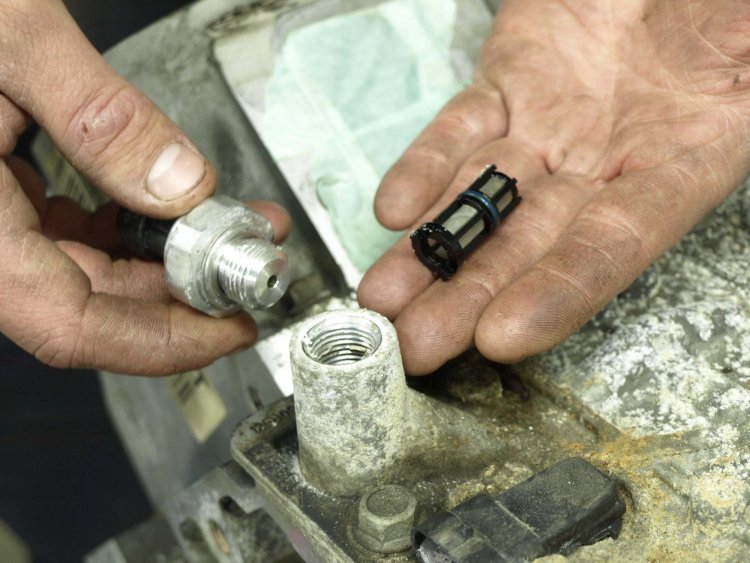

Does you vehicle have an oil pressure sender screen?   If so, did you check it? It is difficult to remove and does not come out with the sender. You need a dental pick or other similar tool to remove it.

I took out the screen and threw it away. Eliminating that problem. I also didn’t mention above, this kit did also a VVT delete. Eliminating the OEM valley cover and those solenoids that control the AFM (on oem valley plate).
