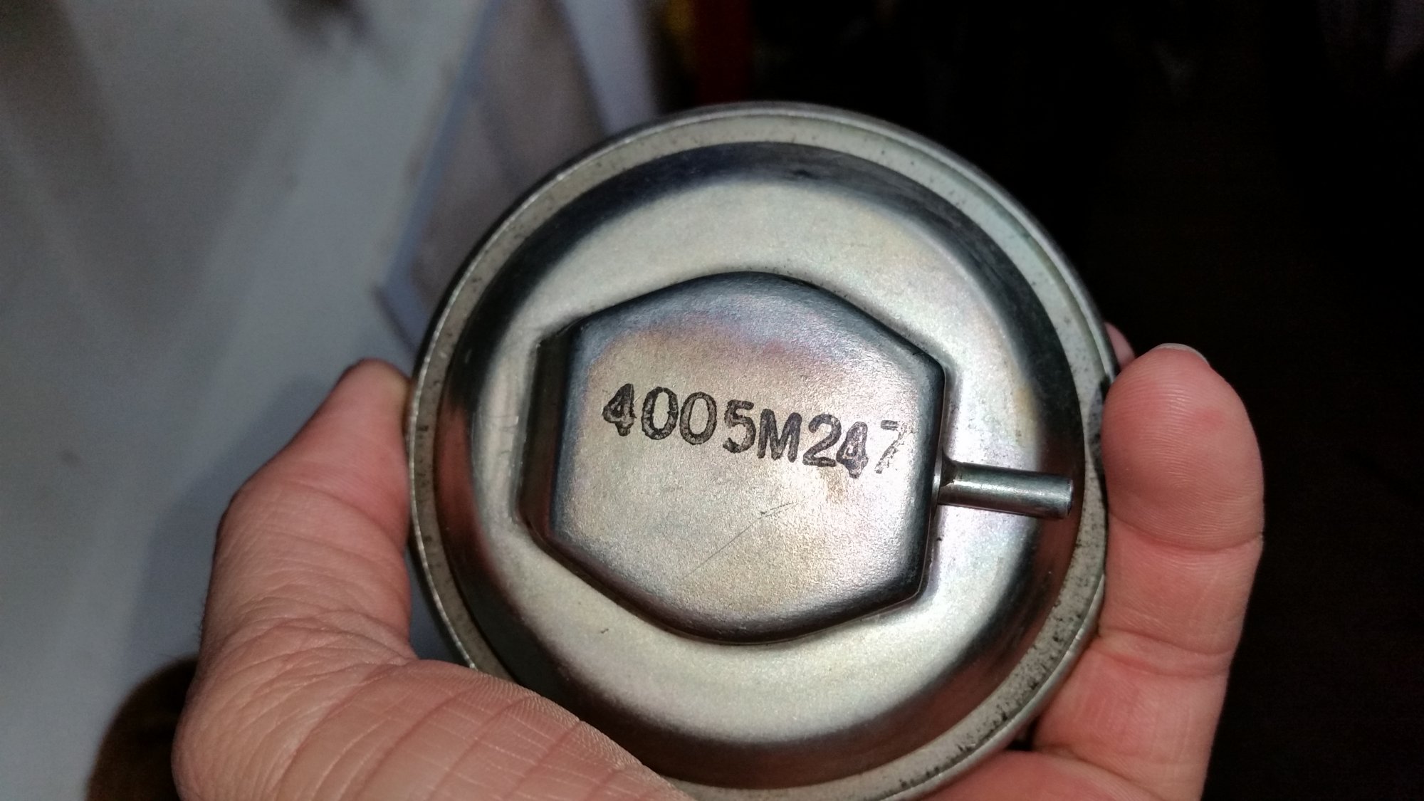

Does the EGR valve have a small pin hole in the location were the vacuum hose hooks on? That small pin hole is to restrict how fast the valve fills back up.
No actually it's just an open vacuum line tube. There's nothing in there that would restrict the air flow
The port should have a small hole. If it is large and clear of and restriction the valve will open and close faster than it should.
Yes it is definitely the bottom one. I wonder why none of the ones I got so far have the restrictor? Ok that's awesome though at least now I know what to look for when I get a new one.
Thanks from me also,I had tunnel vision,it can't be the egr,2of em,I guess I stopped looking for the small hole years ago,lol
Here is all I have. Make sure your current valve does not have that hole further into the stem. I have seen diagrams showing the small hole a little ways in.
Thanks for the pic. Googling came up with nothing though. I'll just go to the gm dealer today and show them your pictures and explain what I need. I've looked at tons of different egrs online now and can't see any that have that. Hopefully they'll be able to get this sorted out.
