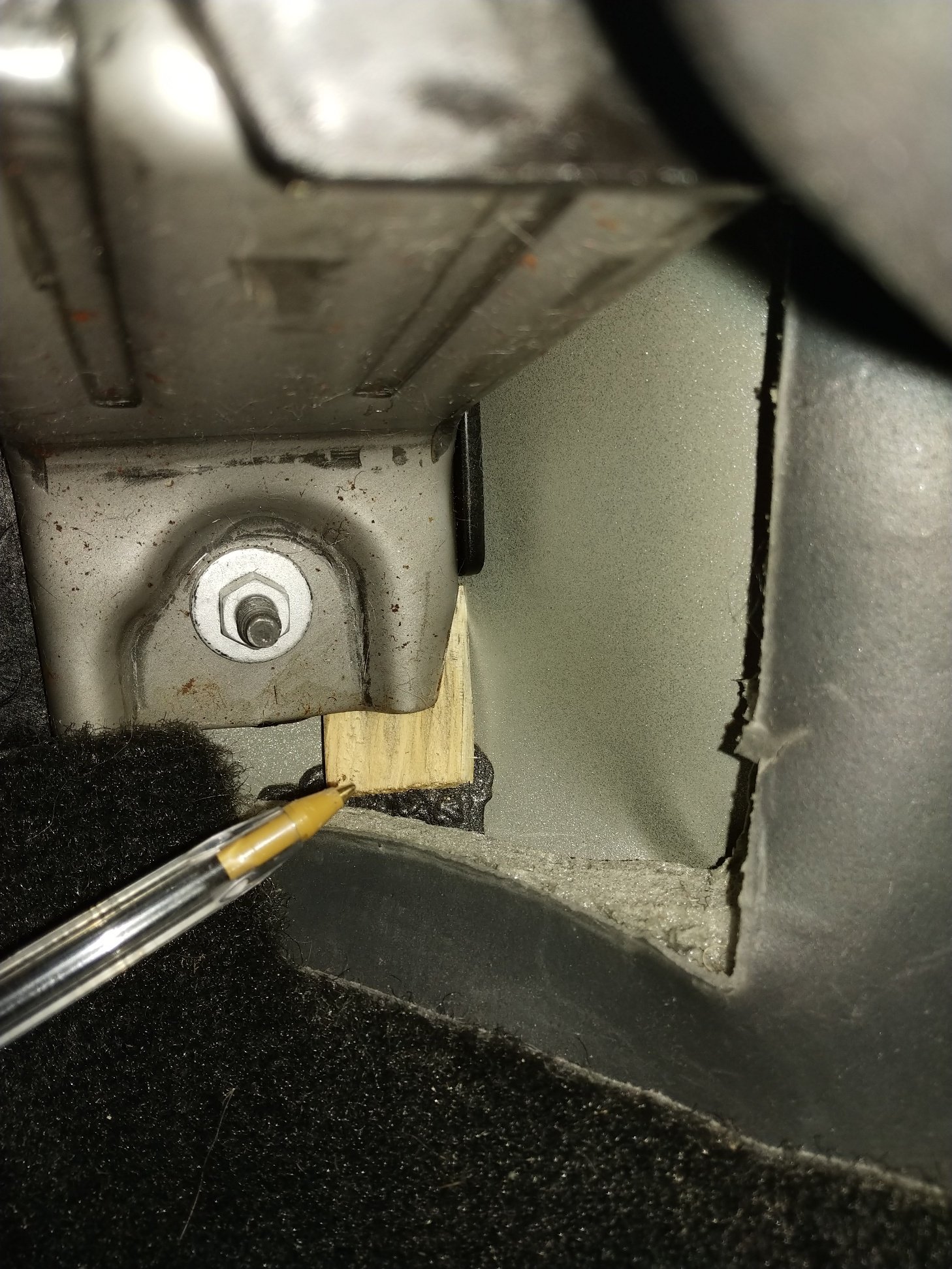

my solution, was actually the paint stick trick.  it must be the plastic pedal assembly rubbing on the steel.  i showed it to my dealer on saturday, when i went in for an oil change and allignment.  i'll try to upload a picture later for you.
21 hours ago, triplexbullies said:
paint stick??? Yes, please post a picture.
here you go. i did this almost 2 months ago and have not had a click sound since.
