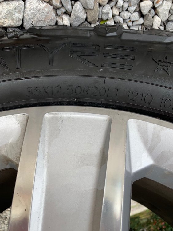

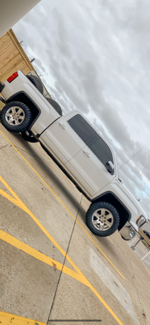

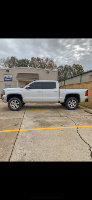

3.5” level with 35x12.50. Got it done today and it worked! Of course on stock rims because the offset is just right. Didn’t have to do any trimming and only rubs sway bar a little at full lock.
So it can be done. Before i got it done I was trying to find people who have done this before and couldn’t find much info so here it is!

You sure you’ve got 295/65?/20? I’ve got Nitto Ridge Grapplers 295/60/20’s which come out to the same measurements. 295/65/20 should be 35’s

Yessir

No just a 2” understrut spacer and a 1.5” pro comp spacer above the strut. My UCA’s aren’t at that bad of an ange. I plan on getting the cognitio ones in the future though

Just have a 2” understrut spacer and 1.5” pro comp spacer above the strut. Had 295/55/20’s before i switched to these. The tires before the 35’s didn’t rub at all except a little bit on the control arm. Added a 3/4 in wheel spacers on the front with the new tires, now they don’t rub it at all

Were you able to get the alignment back into specs?

Yeah the alignment is good to go
