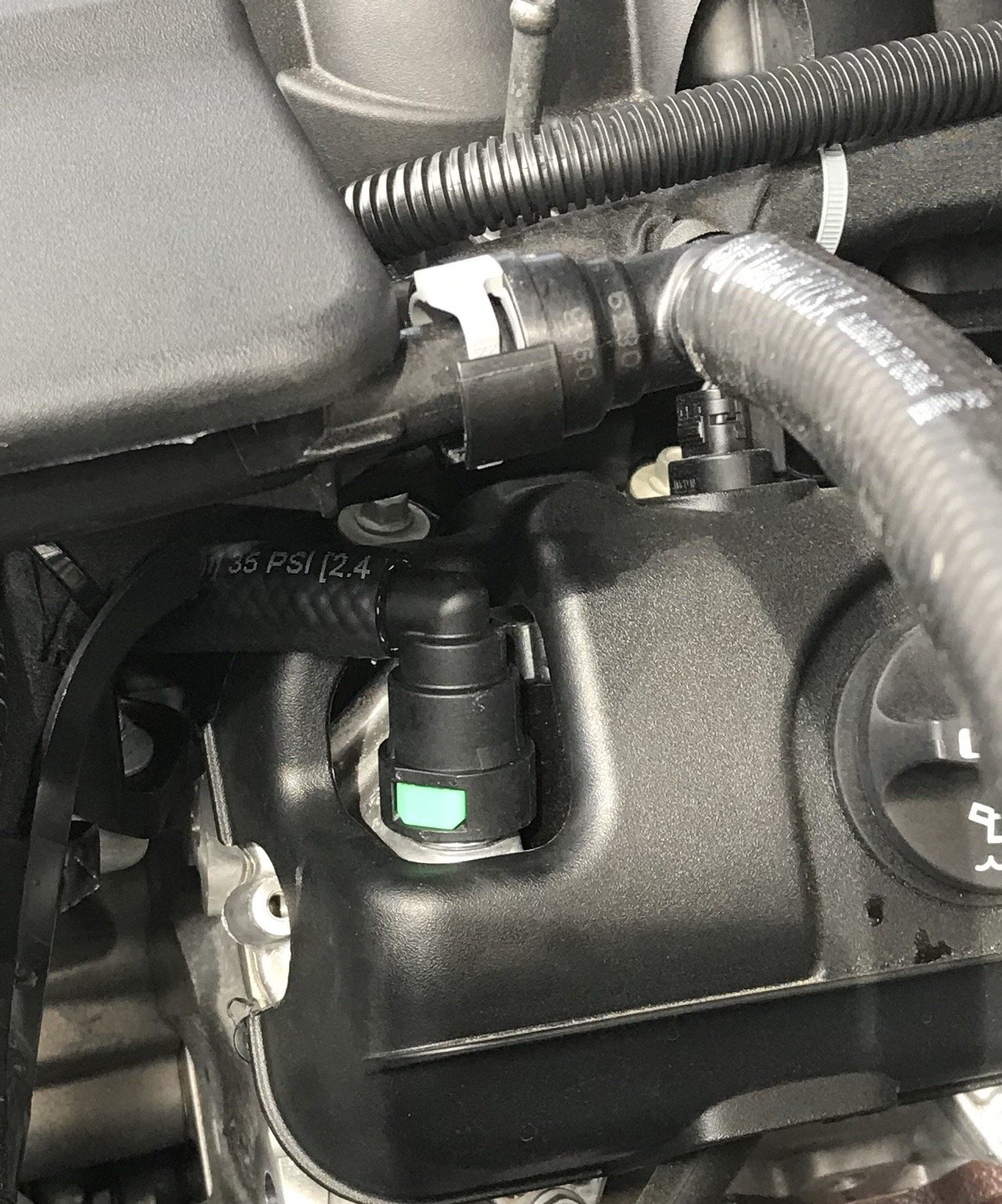

Mike, I did find that the UPR bridge line is almost too good. What I mean is that for most everyone it’s the perfect hose, high quality, nice fittings and hardware. What I found is it’s too thick and or short to run anywhere except over the top from valve cover to valve cover. I’m going to have to re-route mine (as in use a different line/hose) to be able to go under my engine cover. At least I don’t see any way around it. With that said not everyone is adding an engine cover so it will be just fine. If you see the picture (not mine, I’m waiting until I get back to work before I install) you can see it needs to go under the cover or be longer to fit under the TB. Just wanted to share, I’m sure Joe at UPR could make you whatever lines you want but they are not cheap nor should they be because of the quality stuff used on his lines.

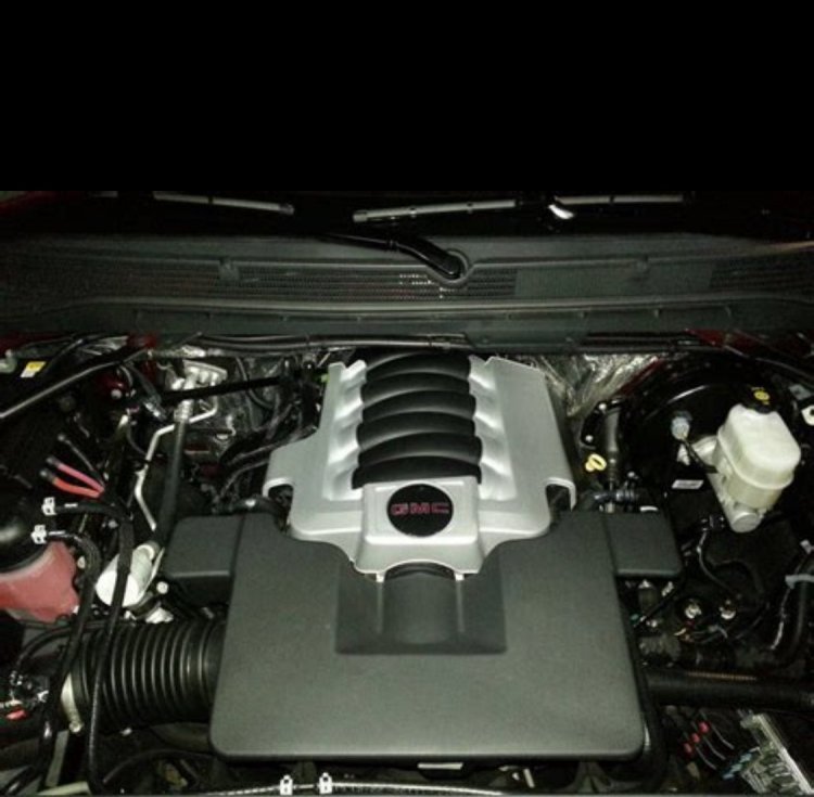

Looks good with the cover.  Is that a Caddy cover with the logo swapped?  The bridge line in valve cover to valve cover?  Does that even come with the standard single valve can?  That's only for the CSS install right?
Yes it’s a Caddy cover, that pic is not mine, I will be installing mine this weekend when I get back to work on it. I was relocating my can to the fender when I broke my PCV valve. So it all went on hold. I’m still driving the Accord due to knee replacement and it’s just easier right now. But anyway, yep Caddy cover and the bridge line is for the CSS or a dual can setup like I have and goes valve cover to valve cover. The cover badge in the pic was changed to GMC...I’m putting an Oregon Duck badge on mine lol...I can’t help myself ?

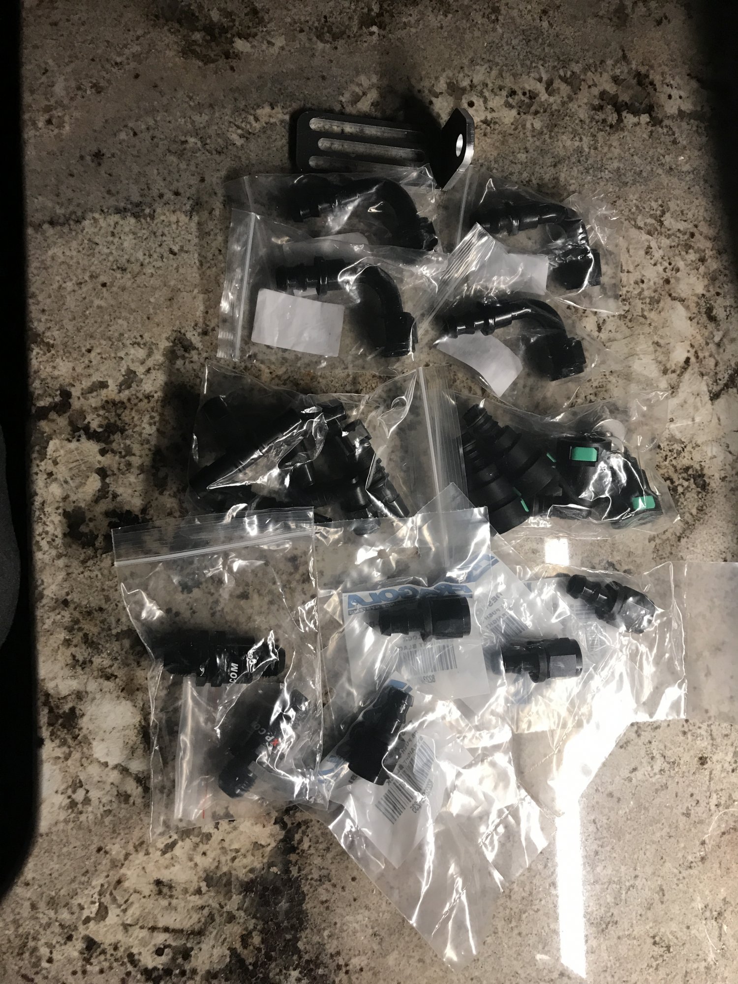

I think they all have the factory connections now. Mine came with a bunch and about 15 feet of hose so I could make my own...it’s RXP but Elite and UPR are all good cans.

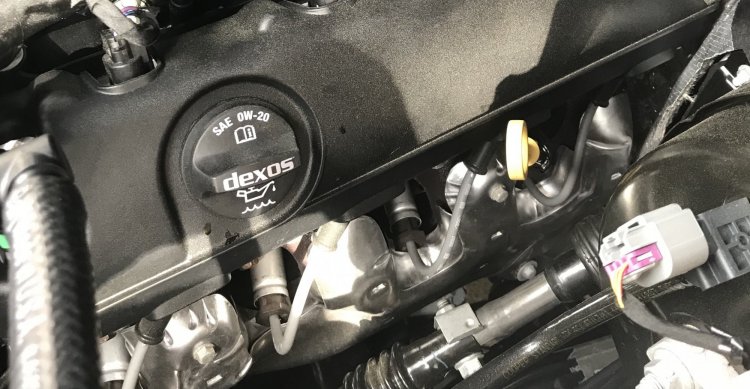

Any issues getting to the oil fill cap with the can installed in that position?  It looks like it might make pouring oil in more difficult in the pictures.

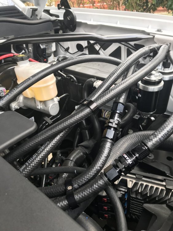

Relocated my RXP dual can setup. Fits perfectly off the fender over the spare battery tray and used the OEM fittings provided. The hose comes in a long enough length that you can pretty much mount it anywhere short of the truck bed lol. There is enough hose that you’re covered if you make a mistake, I had about 3 feet left after install. Just measure, cut (I have a hose cutter, but heavy duty shears or even a box cutter works) install fittings and you’re good to go. The check valves are quality too. No interference with the oil fill cap or dipstick either. :thumbs:
Nice looking set up.  I thought I read somewhere that you were running a CSS, but I don't see one in that picture.  So the RXP comes with factory style fittings, but you make up your own hoses.  Does the UPR come that way or are they premade?

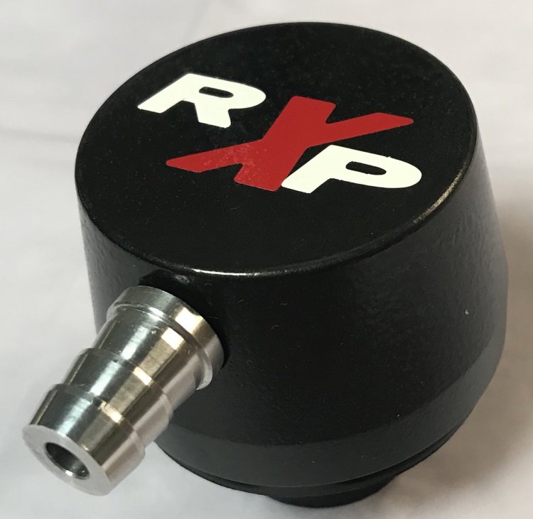

I used to have the CSS and upgraded to the dual can setup which replaces the CSS. This actually catches the gasses and oils that the CSS did but instead of dripping back into the valve cover and going back into your oil, it traps it just like the large catch can does. Here is a picture of my old CSS. Thanks for the kind words and yes the RXP comes with OEM fittings/quick disconnects.
