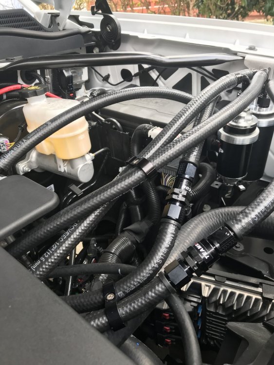

Here is a pic of catch can results after exactly 100 miles. Note that there is virtually no water but is does smell of gasoline. Mounting it on the fender did not create more water condensation at all. The oil has about 1500 miles on it.
Water begins condensating in the can and crankcase when you use the truck for short trips and not warm up the oil enough.
Yeah, I added that comment for the few people who told me that mounting it off the fender would not allow the can to properly warm up LOL, others have said too much heat will be bad too. I guess it should depend on individual case by case basis...if you're in a very cold climate, maybe the fender area isn't the best idea for them but for me in Florida, it's just fine :thumbs:

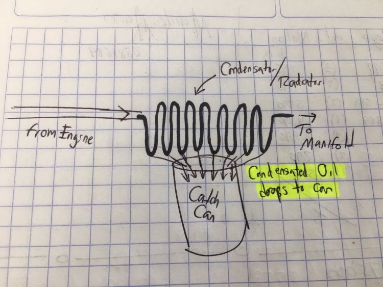

Look, i came up with a design that would catch 100% of pcv vapors... it would be mounted in front the truck, in front of the radiators
Take the Hint, catch can manufacturer

No, Not You :D
I meant that Catch can manufacturers should take the hint about a condensator of some sort lol
