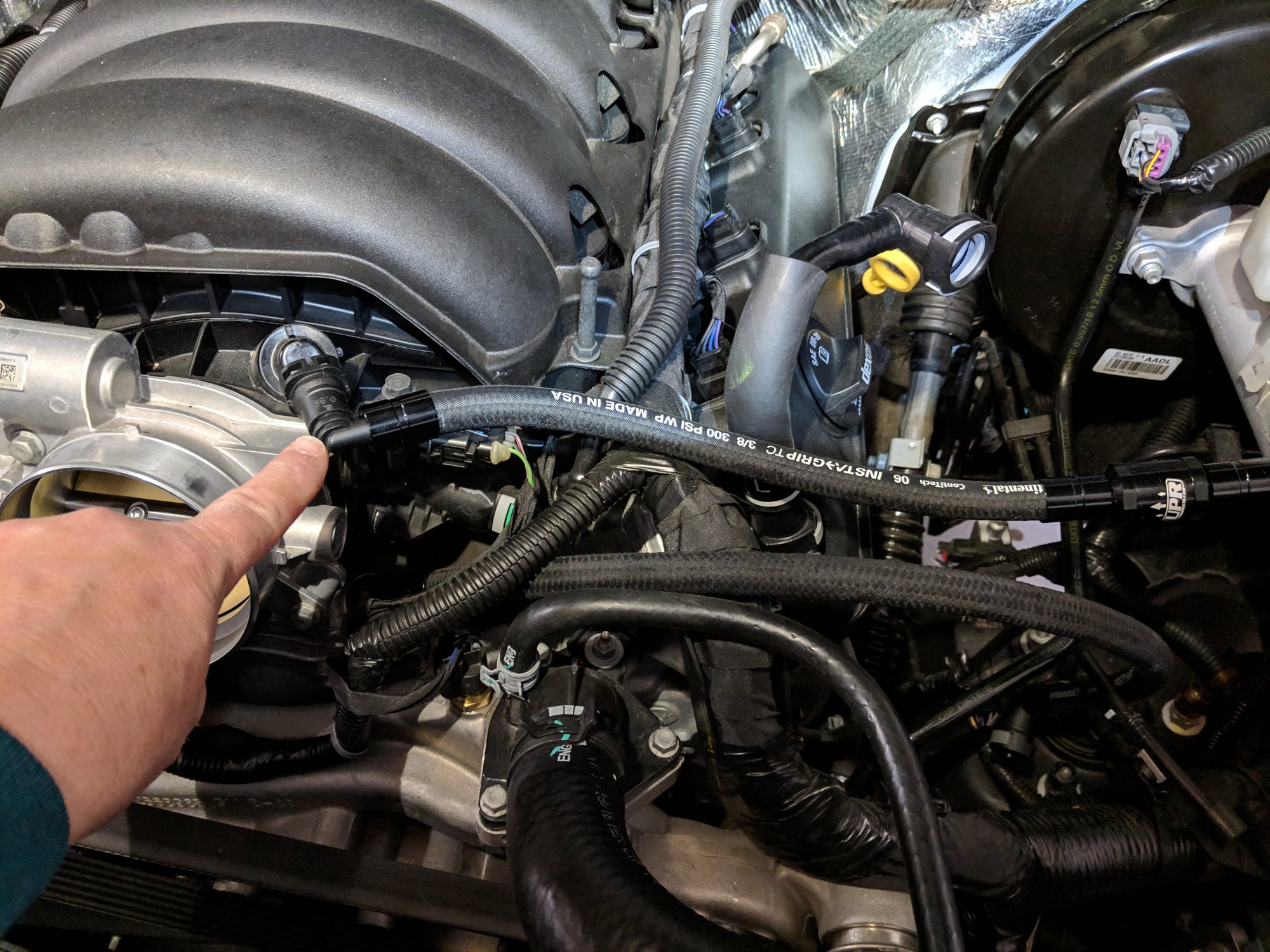

the port fitting in the manifold  looks as if it might have a pcv check valve built in.. it might be a cmall diaphram type valve, needs closer inspection, I dont know why they wouldn't have it built in, the line itself has nothing inline.

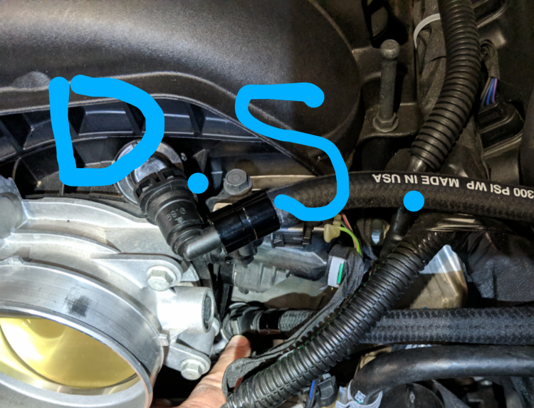

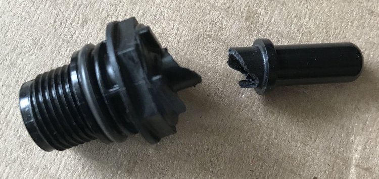

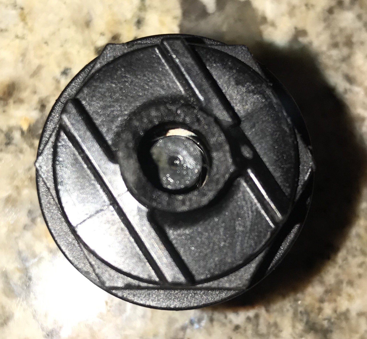

The PCV valve has as best I can tell a flow rate valve. I broke mine this morning disconnecting the PCV line. The QD didn’t open all the way and I (like a dummy) pulled too hard. See the results below ? anyway, I could get airflow in both directions but it could be a check valve set to close at a pressure higher than I was able to provide. I took a couple pictures (best I could get with my phone) for you to see so it may save you or others the hassle of pulling it just to see inside ? I can’t see anything inside the clean port on intake manifold.
ahh just as i thought it does have a check valve, yes it does flow in both directions like all pcvs, but it closes when presssure exceeds a certain level of vacuum or positive crank case pressure,
so there is no need to add a check valve on those aftermarket catch can kits.
