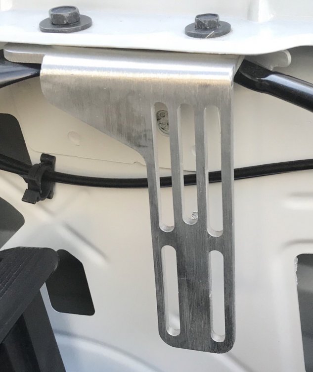

UPR single side catch can install 2018 GMC Sierra 6.2.

5 hours ago, Mike GMC said:
Any issues getting to the oil fill cap with the can installed in that position?  It looks like it might make pouring oil in more difficult in the pictures.
Can is completely out of the way. The lines do run over it, but are flexible enough to not be an issue.
Even if they were in the way with the UPR lines you can easily pop them off and out of the way, they use (as you know!) quick disconnects...push a button and pull, done.
True.  I'm just a bit Leary of that install location and the UPR locks you into it with the premade lines.  I really liked my location on my 15.  I had it on the radiator core support on the driver's side near the spare battery tray.  Just to the side of the fan shroud but not over the tray.  It was well out of the way of pretty much everything.  I had to make a small notch in the plastic cover over the core support, but that was it, just find a suitable bolt and use an existing hole.

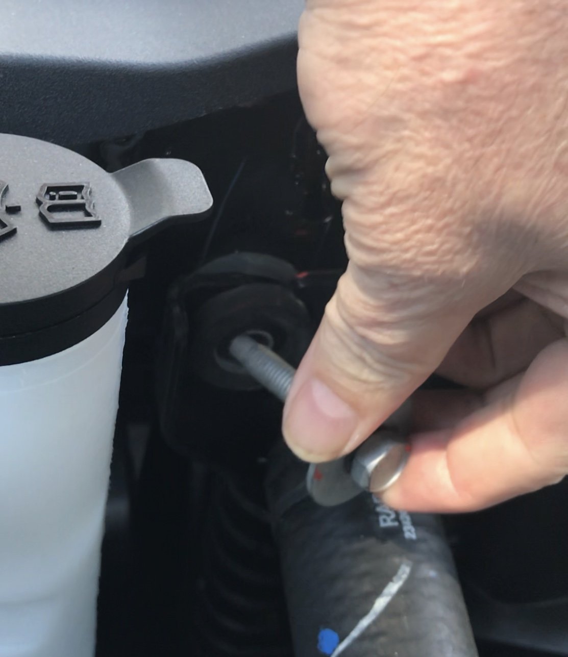

I know this spot! Was one of my test fit areas and it’s a good one for sure. This is a screen shot of the video I made for install in that same spot, very easily accessible and out of the way! That’s the bolt for the radiator support and it’s a heavy duty bolt. It’s pointing right at the hole with the heavy rubber grommet.
***Oops, maybe not where you are talking about now that I read the whole post but this works well too and uses the existing bolt***
Very close to the spot, it looks like the heal of your hand is on the spot I used.  Just trimmed a notch into the plastic cover were it folds over the edge.
Yep, good spot too, the spot I show is great if your bracket allows it, I decided on the fender brace location ?
