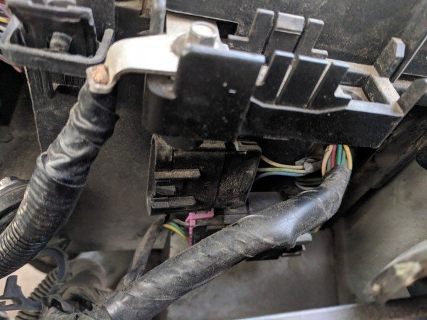

04 2500HD 8.1 - Can someone identify these 2 plugs near the fuse box?
That plug near the base of the fuse box (top photo) looks like the plug for the 4wd system (the 4wd harness plugs into that).  It's open/unused if your truck isn't 4wd.
The bottom picture with brown, black, gray wires is connector C153, black, 3 wires. This connector contains 4 Wheel Drive wires, for front axle switch, and LOW Range Signal
Anyone know what the top plug is?
