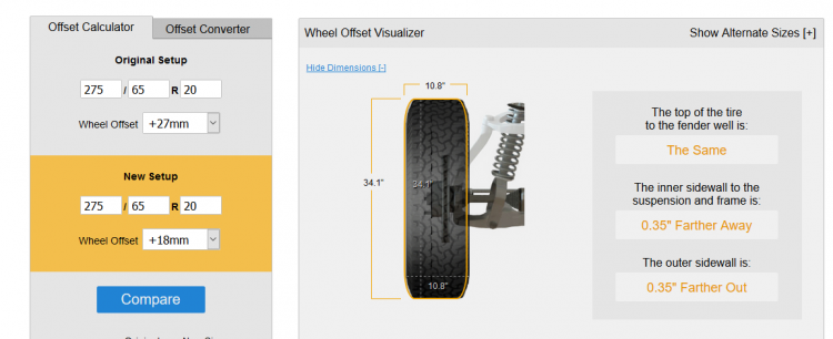

Have the same size tires on mine (275/65R20 BFG KO2). Installed a procomp 2.25" level kit and had to zip tie the passanger inner fender well back and it will barely rub the UCA on the passanger side on a full lock turn to the left. I can still make a uturn across 2 lanes and i havent had any issues driving.The only way to fix the rub on the UCA is to have a wheel spacer or a wheel with less backspace. The stock rims are +27mm offset i believe and something like a +18 would probably do the trick. I didnt really notice a difference in the way it drives other than the fact that im much higher off the ground.
