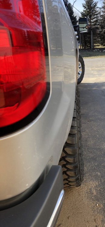

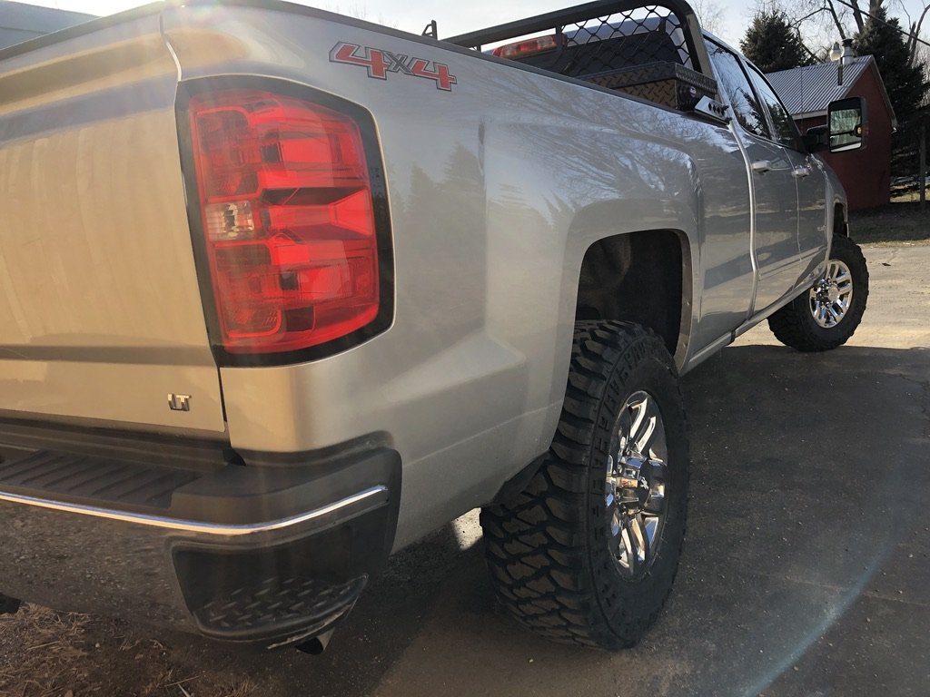

5c9badb0a7709_0iAXrOG7QCvZBMYPNe2vw_thumb_7382.thumb.jpg.40365ab7809d74c7c87e5443238731c1.jpgUNADJUSTEDNONRAW_thumb_7465.thumb.jpg.6703cdbd177bd5aaf2eebdd0a0b0573f.jpgUNADJUSTEDNONRAW_thumb_7381.thumb.jpg.5ca89366b41bf9b146720e92e3055b20.jpg
I posted these already but this is my '17 3500 bone stock. 295/70/18 MT Baja MTZ P3 with no level, no spacers, no rub, no trimming, on stock aluminum wheels.  I had already removed the lower valence but I don't think it would've rubbed.  Mickey T calls these 34.5 x 12.

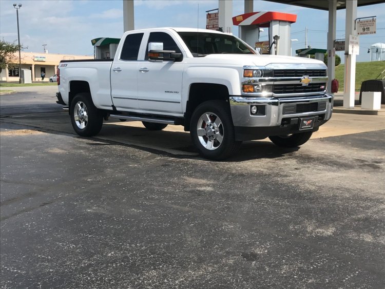

Been running 35x12.5x18 BFG KO2's on my 2500 with completely stock suspension for 14k miles now. no rubbing fender well, air dam, etc.

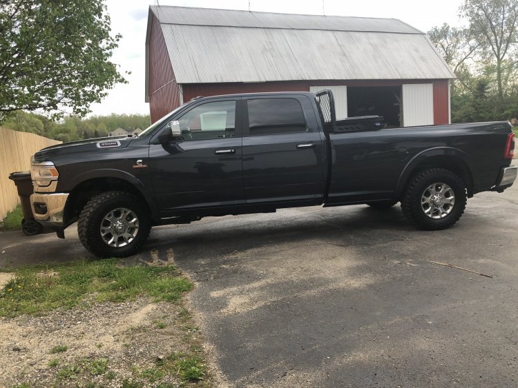

Solid intel. I figured 35x12.5 would fit. Good to know for sure though. And also good to know that 2500 and 3500 ride the same height. I traded this in for a ‘19 Ram 3500 Cummins HO and I took the tires with me. The Ram rides even higher. There is tons of room for these shoes now.
