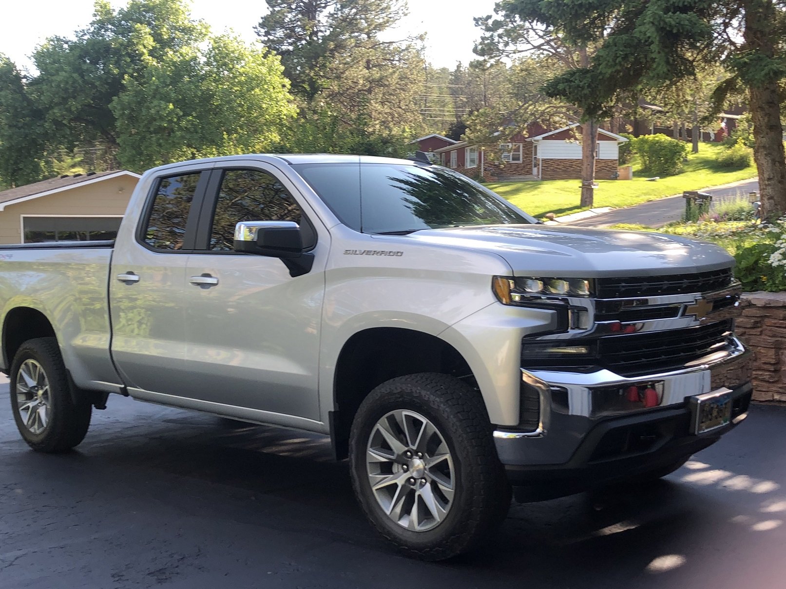

I asked them to inspect the box I brought along to convert my 3.23's to 4.10's.  Was told the rear wouldn't work, nothing about the fronts.  Then called the place I got the ring, pinions, bearings, etc.  from and was told the rear WOULD work, but not the fronts.  Conflicting information.  Was also told the front ring could be a welded on ring.  Hated to hear that.
My RPO code for the setup is:  SU5, G80 (locking RR), and  GUS (3.23's).
Have made a helluva lots of Internet inquiries, phones calls and now I'm thinking NO ONE knows anything for CERTAIN of how/what to do the get this thing geared down.  Was also told I needed to purchase a GM 84557636 front diff assy for around $1,000.  Then, I was seeing that even that won't work on the 2019 LT Silverado New Body Style.  I only have 3,000 miles on it and it's kind of a toy for me, so gearing it down was kind of a fun thing to do.  I  used to do all this on my NHRA drag racer years ago, but boy things are not so easy now.
