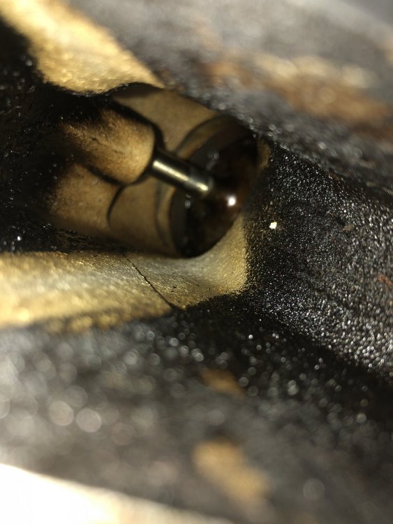

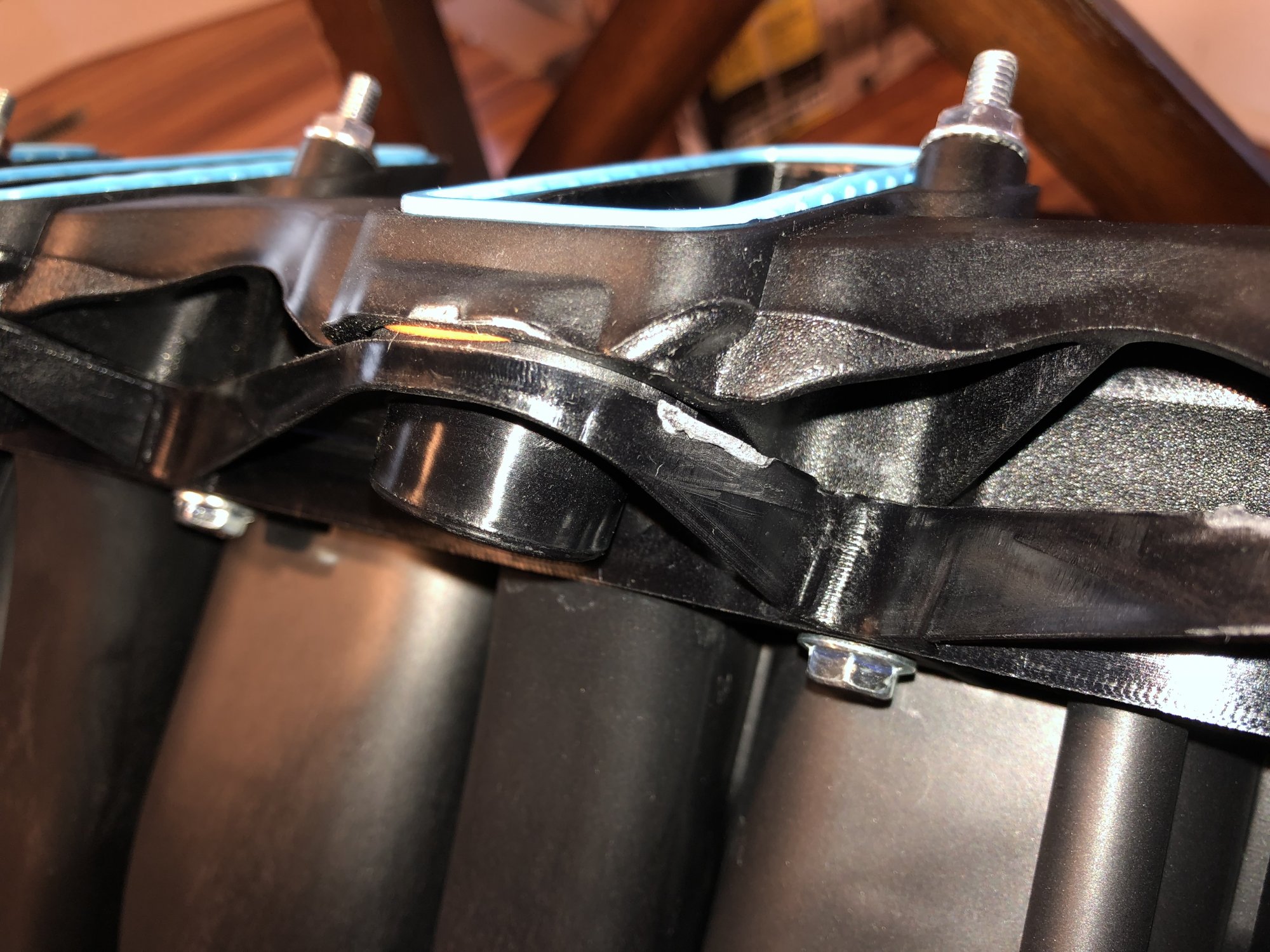

i have a phot of some sloppy factory gluing. I was told this shouldn’t effect leakage.
I have a Dorman LS1 intake on my LS1 Camaro and I love it. It installed like factory and no leaks. I did have to do some clean up of the runners but it was worth it.
From what I understand Dorman bought the rights for the lower portion of intakes from FAST and they Sonic weld their own upper design to them.

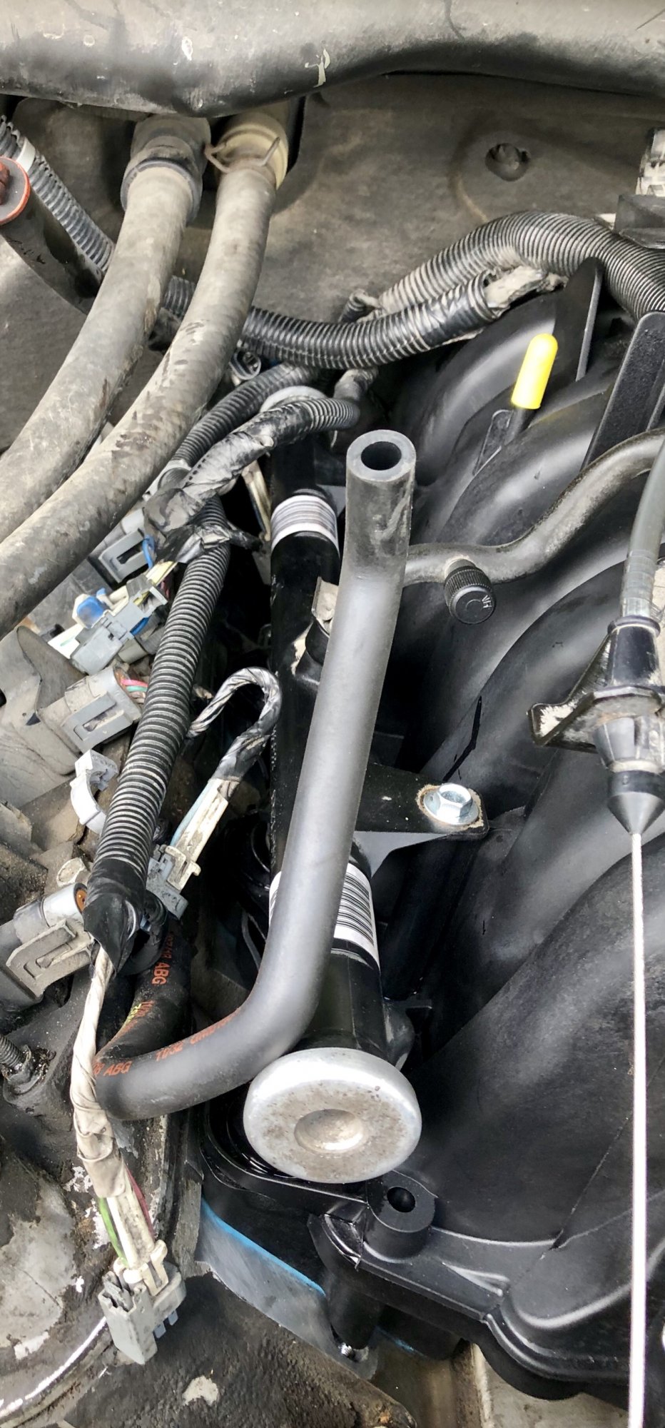

Putting it on today finally lol.    I’ll take pics
Seemed to go on just fine!  Will update the status once I tow my trailer around for a bit.  I threw p0101 again right after the repair when I hammered it down.   I realized though I left the Pcv valve disconnected ;)
code self cleared very quickly
my knock sensors were bone dry and looked great
My sponges were in good shape and still felt rigid.  I think it helps I’ve never washed the engine ever, and I’ve owned this since it was brand new. I was expecting water issues but honestly there were none.
Lots of squirrel nuts and bugs.  The daddy long legs was dead and crispy.  ;)    The piston chamber or whatever you call it was really gunky.  But seems OK.
Honestly the job was way easier then I thought it would be.   I spent more time trying to figure out how to remove the fuel injector lock caps and at the very end I couldn’t find the egr sensor and ended up It got tucked under the manifold.  Glad I didn’t torque it down without it lol.
Truck just feels cleaner running now when accelerating.
Couple notes on the differences of intakes
-no modification is needed from wiring harnesses
-map sensor goes on back of dorman intake and its on top of oem intake
-the evap solenoid?  Connected near top left throttle body is sort of in the way of the hose connection but it works and doesnt need modification
-the dorman intake has this white plug next to the intake I have no clue what that is for,   Maybe an egr valve?
-you cant re use same bolts you have to use the self threading screws in the kit
-the 10mm intake bolts slip real easy so make sure you have a good socket
