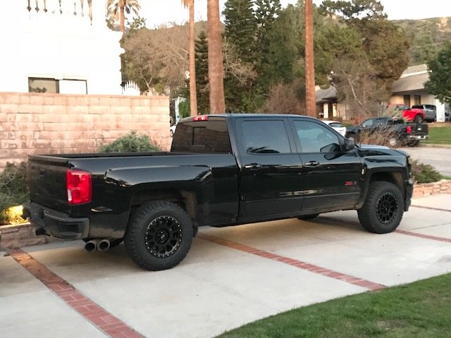

Hello everyone. Ive searched and searched and finally have to take the walk of shame with another wheel fitment post. Can you guys give me your opinions? I have a 2018 Z71 with the Fox 2.0 Coilovers and rear shocks. I just put Method NV305(5.75) 18s with BFGoodrich KO2 285/65/18s on. Im really happy with the setup, feels great but i wouldn't mind beefing up the tires a bit as there is some room. I was wondering if any of you think id have a rubbing issue if i were to go with the 34x12.5 KO2 which would run exactly an inch taller and an inch wider then my current setup. It would be a 33.5inch tall tire. You think i could get away with it? Here is a pic of how its currently sitting. It seems i have a bit of extra space for a bigger tire. Thanks for any help in advance! Have a good one.

I have 17x9 Method 315 with -12mm offset.  My wheels stick out about 1.25" more than yours, so width shouldn't be an issue.  My tires are P285/70R17 so the same OD as yours.  However, I did have to zip tie the fender liners back so the tires wouldn't rub at full lock.  I still hear a slight rub if I hit a bump while backing up at lock.  If you go 1" more in diameter I think the rubbing will be more severe. You might have to cut metal in the back of the front wheel well area.
What is your wheel offset? I run 33x12.5's on a 2.5" level. I have minor rub on the UCA and swaybar at full lock. This is only because the factory GMC AT snowflake wheels are a +27mm offset. I think if I was around +18mm I would have no rub at all. If you go to a 0 or a negative offset, you can start rubbing the bumper/fender liner. I also have Gatorback mudflaps with stainless bolts so that takes another 1/2" away from my overall tire diameter clearance. I would think with a +12 to +18 offset and no mudflaps, and a true 2.5" off lift you should be able to fit a 34". If you have a preferred tire shop that likes you, they can mount one 34" on the fronts and check it in their shop before you buy new ones from them. I did this with my 2010 because I went to aftermarket wheels and wanted to check the max size I could with that new offset.

Nice setup man looks really great.
Thanks for the replies everyone i appreciate it. I believe the wheel is an 18 offset, its a Method NV305 5.75. I have a buddy at the shop that i could try it with. So i guess best thing to do is just go down to tire store and see if i can get the fronts mounted as a test. The guy has been there my whole life hopefully he will be cool about it.
With the Fox 2.0s and level, I got some full lock rubbing with 34.3 x 11.6 on +1 wheels after trimming and removing mud flaps, and no rubbing at all with 33.2 x 10.8 adding flaps back.
