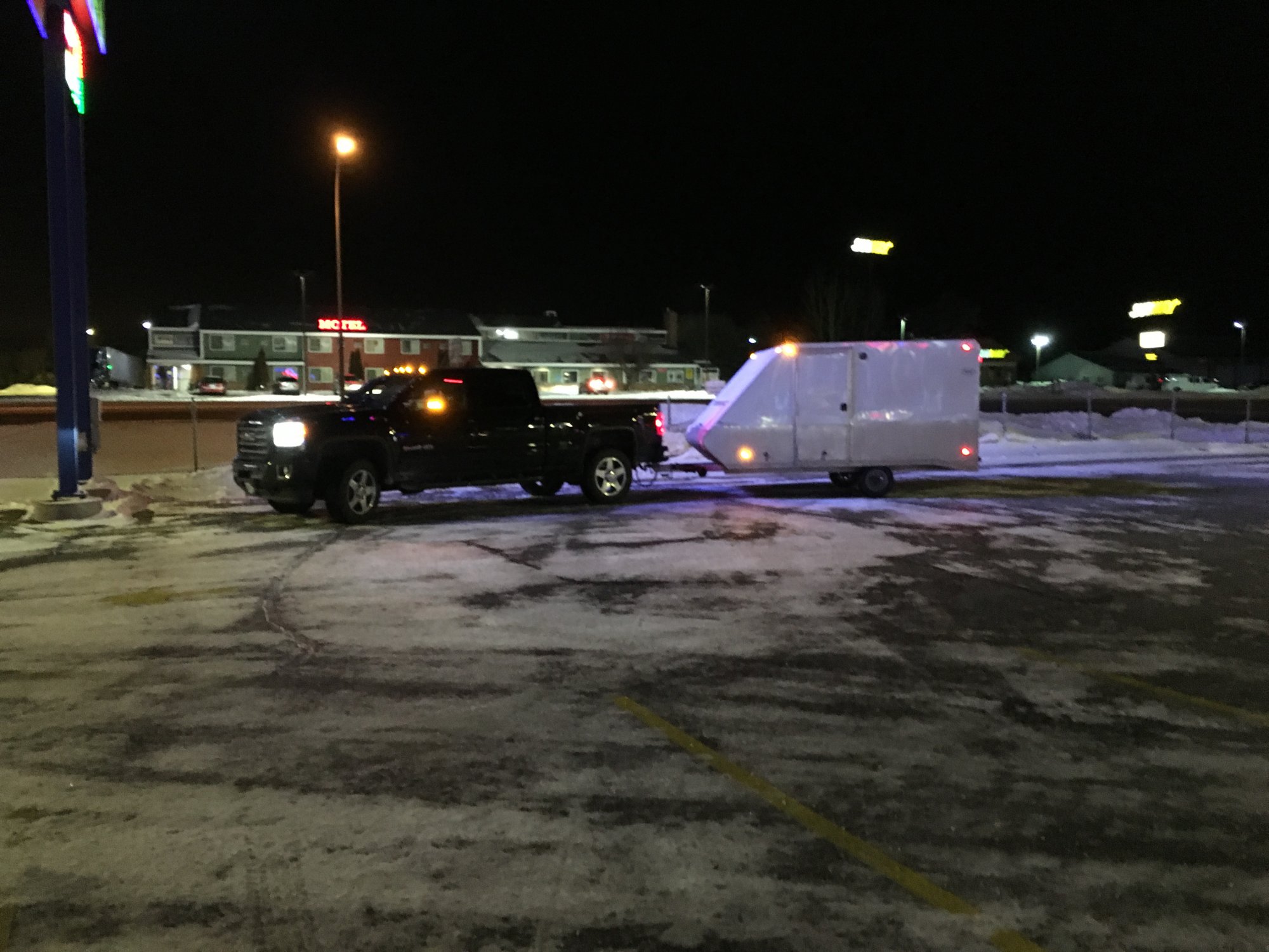

I pulled a couple snowmobile trailers earlier this winter, neither of which  phased the truck much at all. The first one was a small 12’ hybrid; which the manufacturer lists as having a 21” hitch height, yet it sat about perfectly with a 4” drop hitch (that math doesn’t make sense). The owner uses a 2” drop flipped upside down on his 1500.

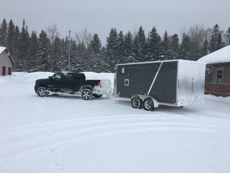

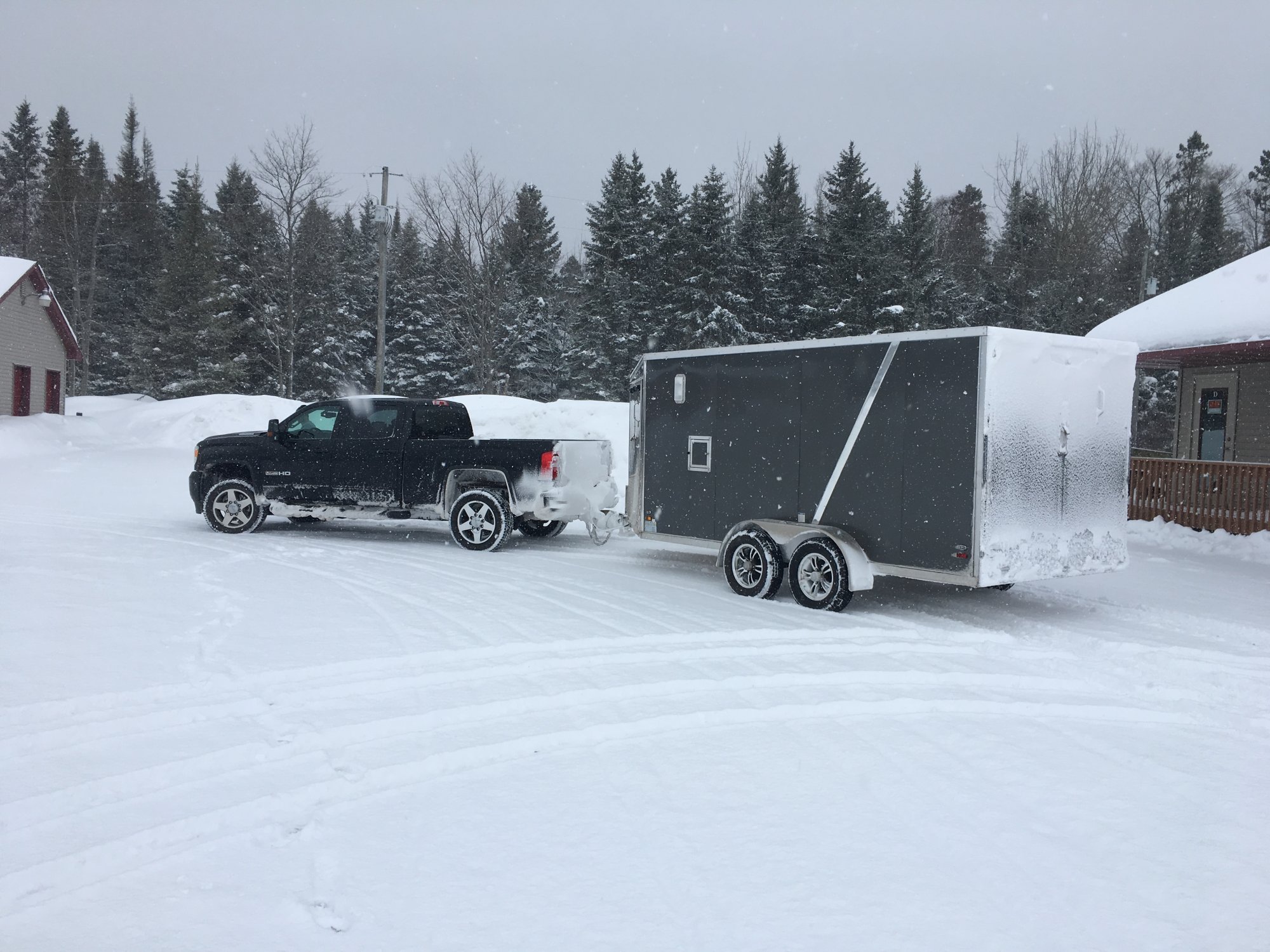

The second trailer I mentioned is an inline snowmobile trailer (think it’s 14’ plus a 5’ v-nose). For this, we used a Weigh Safe 180deg 6” adjustable aluminum hitch. I want to say we adjusted the hitch about 1/2 to 2/3 down. The trailer/hitch owner has a new Super Duty; we had to raise the hitch 1” for my truck since ours are a tad bit lower.
