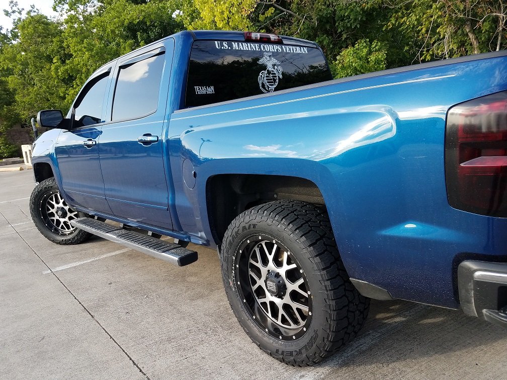

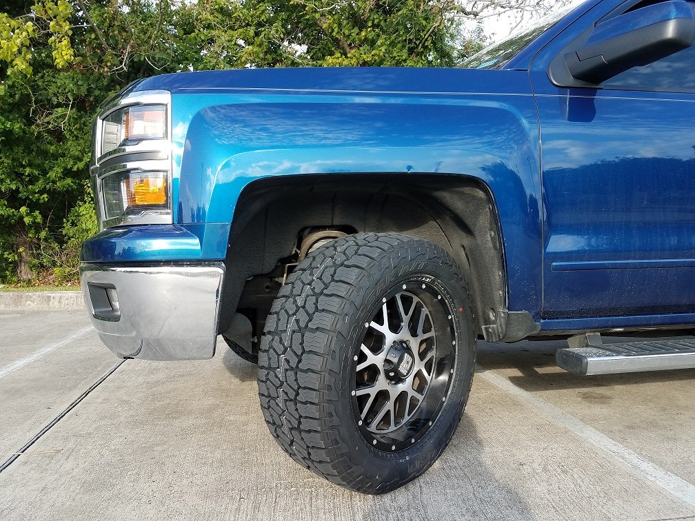

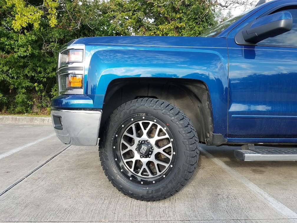

I'm running the Falken Wildpeak AT3s, 305/55/20, with a 2.5 level and I only rub on full lock in reverse. And it barely rubs at that. My wheels are 20x9 with a 0 offset and they sit just about flush with the fender.

Nice ride!

Thanks :thumbs:

Wow, that really looks good! I kind of wanted to stay with the 18" sizes just due to all you read about the Chevy shake. I don't have the shake now. But after looking at this pic, I like those! And the 0 offset might just work too. Decisions, decisions. And I started reading through the "lift kit" thread. Man, now I'm thinking I might want to go with a lift. I should just stay off this site. Lol. Thanks for the reply and pics.

Thanks man, this site is really good at making you want to spend more on your truck. LOL  I'm still planning on doing either a 4.5" or 6" lift, maybe when these tires wear down and I need to replace them. I want to put some 35s on these wheels.
