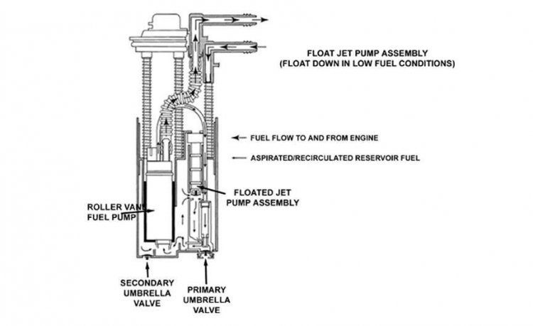

First Design, has a simple umbrella one way valve on the bottom of the plastic bucket. This allows fuel into the bucket to surround the pump and avoid misfire as this is an emissions no no.

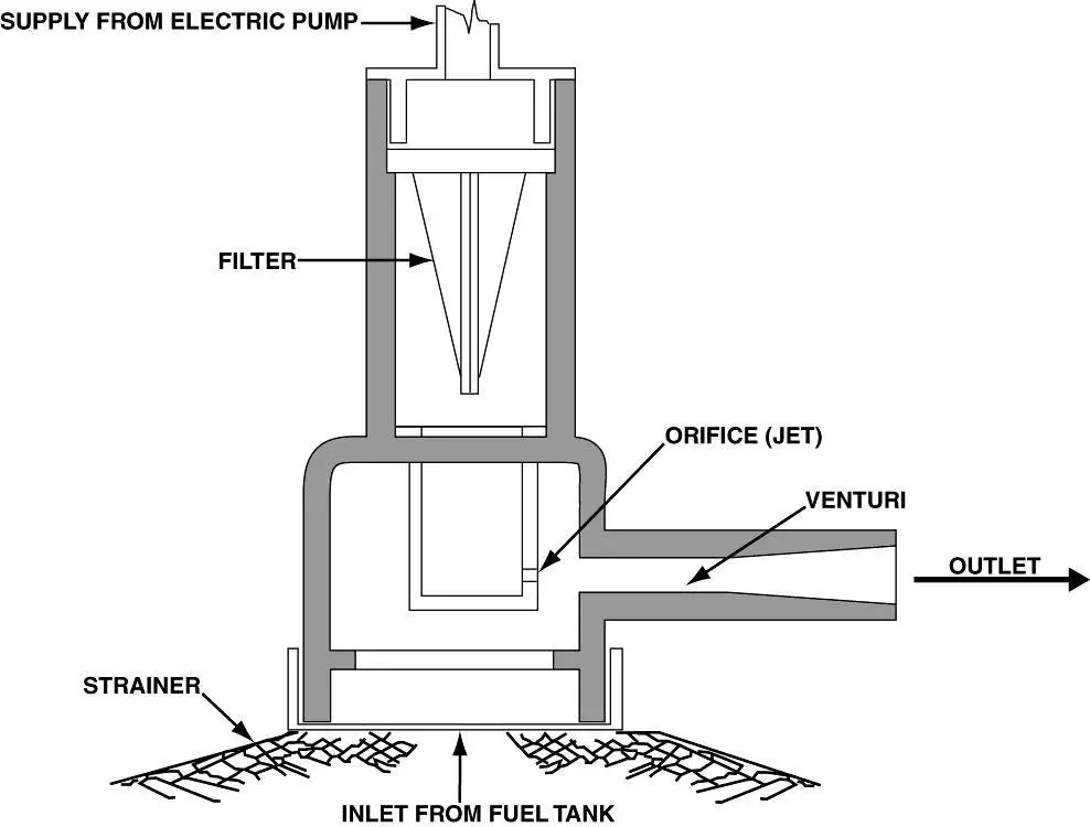

Second design: This has a small high pressure bleed on the pumps outlet. This tiny fuel volume travels to a brass jet on the base of the bucket. Its is used to create the venturi effect, to create a vacuum on the bottom sock type screen. But it fills the bucket for reasons above, put passes though a second sock-type filter on the pump itself. This type by design will draw all of the fuel it is exposed to regardless of the amount of fuel, turns or movement. They even include a float to release fuel if too high inside the bucket on many designs, plus, with return type fuel systems, the return fuel is dumped into the bucket, not the tank. (I will try to post photos).

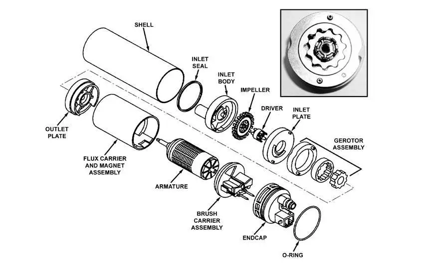

#2 G-Rotor pump

#5 Venturi Vacuum Valve on New Bucket Types

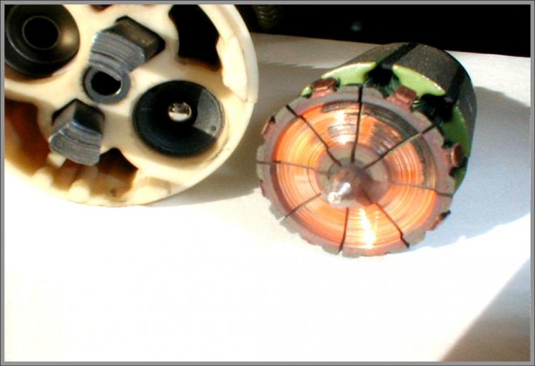

#6 Worn Commutator plates / Plastic shown is the BLK

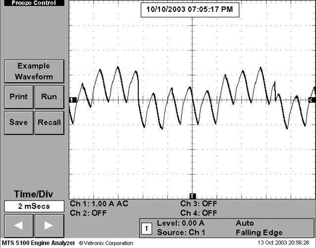

#7 Worn Fuel Pump Amp clamp wave pattern
#8 Good Fuel Pump wave form Pattern

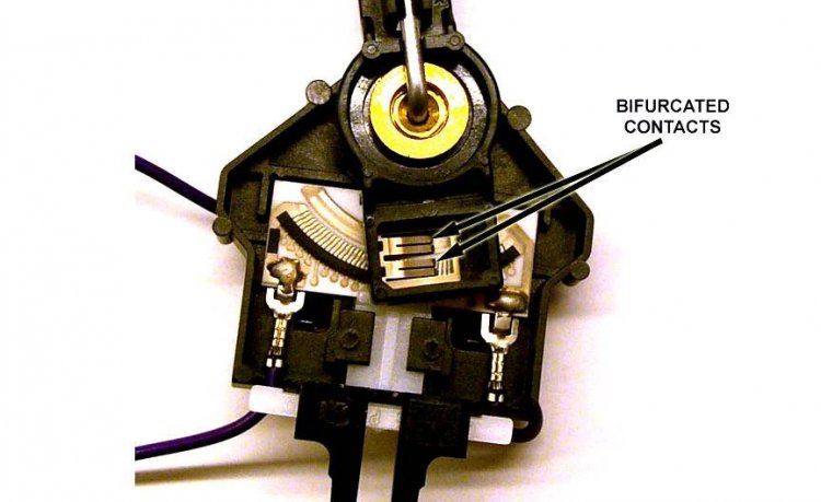

Sulphur is bad, so it attacked the ceramic card with the silk-screened resistor ink that contains silver, to turn into silver sulfide. The sender would not read very well and some people ran out of gas while showing full. In "some" models they changed the reading from 40 ohms full, to 280 ohms full. It remains that way today, 40 ohms empty & 280 ohms full. Some vehicles have to have the PCM reprogrammed to fix this reading, plus the speed at which it reads. People complained that when the had 1/4 tank and turned off the interstate, it would go to empty. So new programming changed the re-fresh rate of the sender to once every 12 seconds and only 20% of the last reading at any given time. So the ceramic card has ink with gold, nickel and other stuff. This make the type of fuel sender important too. I don't think some brands know about this, or sell the updated goodies.

#2 Fuel Sender Ceramic Card /certain metals other than silver.
