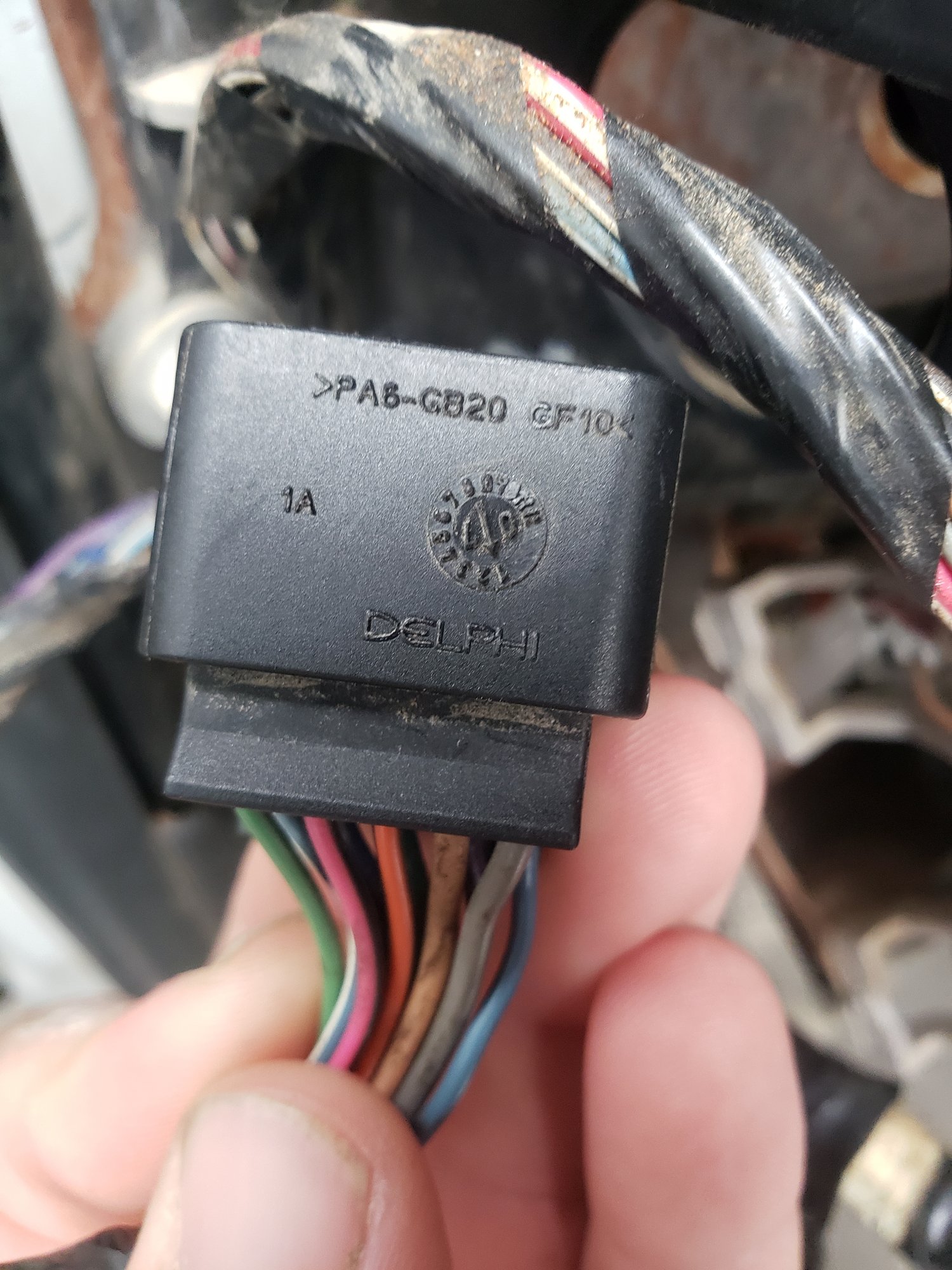

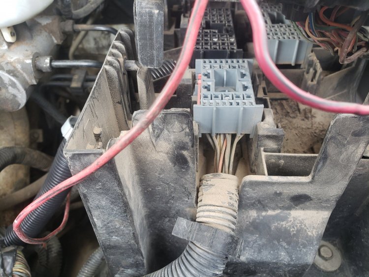

No left turn signal
Just bought a 2008 Chevy 3500, someone's been into the wiring. Some burnt wires and corroded har esses. I need two new ones but haven't been able to get anyone to give me a name. Any help would be appreciated. Need both Male and female and a short pigtail on both on the first pic, and need just the plug and some wires on the second.
Part of the wire harness and not normally listed or sold separately.
Two options, used one with cut wires and spliced together (not recommended)
The metal clips inside the plastic can be removed. There is a tiny barb that holds each clip inside. Small, flat metal slid down the side will release the barb allowing for clip removal. Once out, the individual wire can be repaired and the clip reinserted into the plastic.
