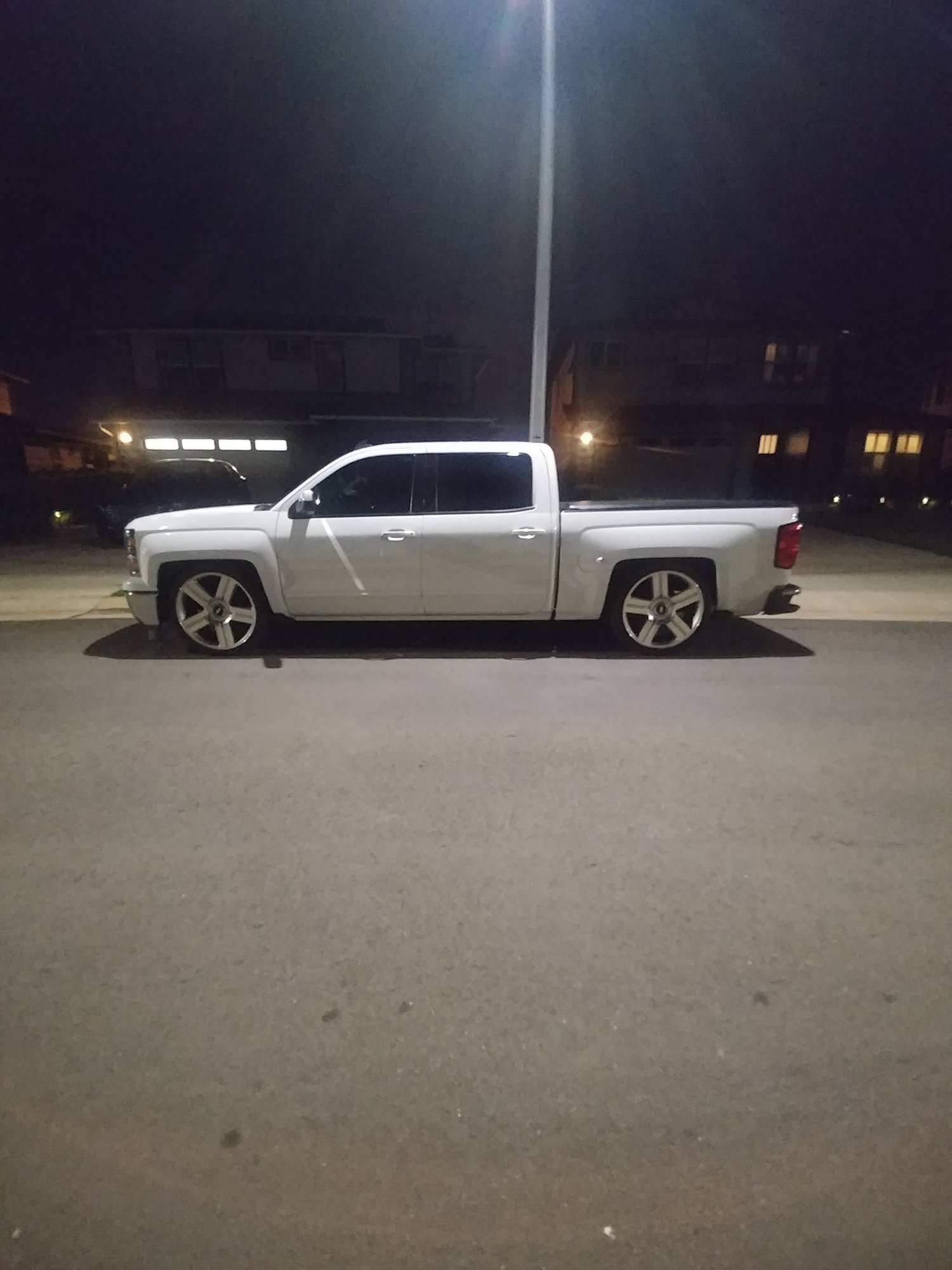

Anybody got any experience with these new belltech coilovers? I just purchased Vikings coilovers for my dropped 2015 silverado.. And not a month later I find out belltech released their own. I think the part numbers are 16002 and 15002.
Still to new i think. But if you already have vikings, dont swap them out for belltechs.  I do the viking swap for tons of local guys and its perfect
  • Thanks 1
Yea I hope the Vikings are good.. Thanks that makes me feel better lol. What size drop are most of those Viking customers running? Right now my truck is pretty slammed, I have drop arms and belltech drop struts in front and maxtrac flip kit in back with belltech shocks. I think I'm at 5 6 or 5 7 and I have 24s. Of course the ride sucks right now, will the Vikings make any difference with such little space between the tires and fenders?
2-3" is best just out of the viking. Them being double adustable makes a big difference.
Use the twisted metal works kit

I'm reviving an old thread here.
Found this thread looking for coilovers for my '15 Sierra. 2”-3” front drop is probably about right for me. Thinking I need about 4”-5” in the rear to level the truck out.
What would you recommend for the rear? Would love to have double adjustable components at both ends. Also not sure I want to go with a full flip kit.
Any thoughts?
