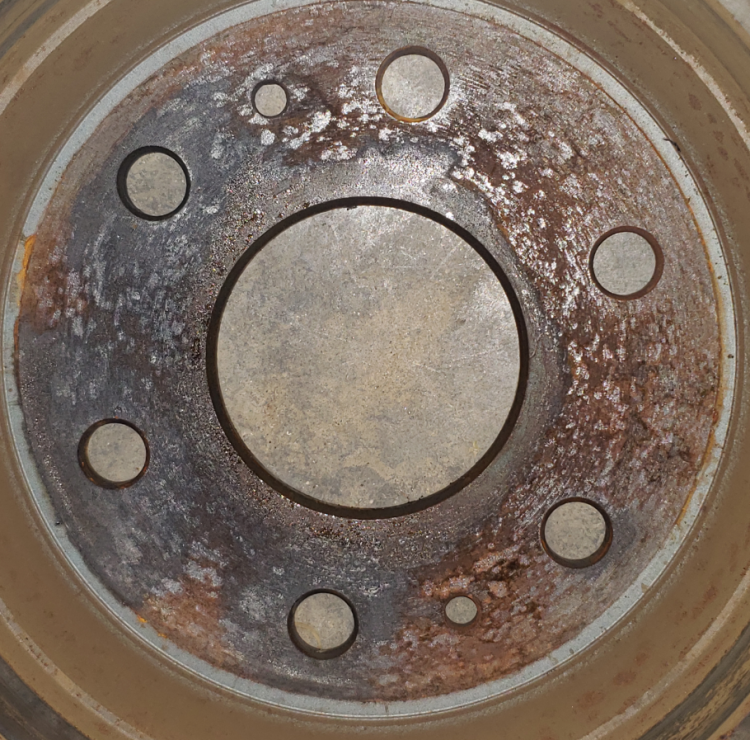

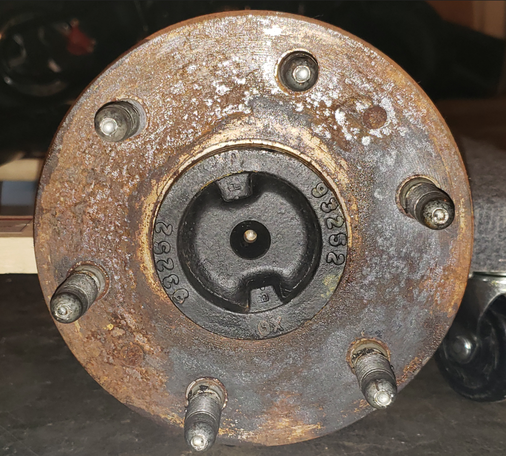

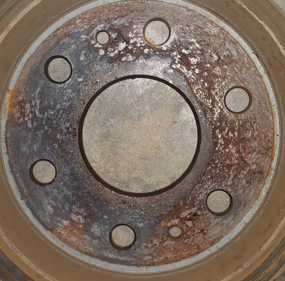

The horrible vibration on my 15 CC was corrected by installing new Yukon Axles (rear) and rear rotors and pads.  The driveshaft was balanced, but  did not make a huge improvement. Check out the lack of mating between the axle and rotor. That will show just how bad the flange is off. The vibration was crazy betwwen 70-80 and could not go above that speed. I knew it helped as soon as I replaced them, now I just hear tire noise. The entire resonance of the truck changed.

Also on those rotors, slap a very generous amount of anti seize on it. You will thank me later. I have seen huge mechanics swing huge hammers to the point of braking the rotor into 3 pieces to get them off. Have to wonder what that does to the axles or bearings.
