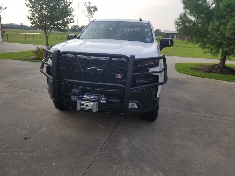

I'm starting my winch install and brush guard on my trail boss either tomorrow or sunday. Has anyone else installed a brush guard/winch on these trucks? Any tips? I'm going to try and remember to take a lot of pictures but i might have to see how my patience holds up for that lol.
Alright so the brushguard and winch are installed. I planned on taking a bunch of pictures but it was way to freakin hot. Over all the install is not bad. The instructions are pretty terrible but they do get the point across. I think wanted me to install the frame brackets with the bumper on but theres no way that's happening. As far as the brush guard goes everything went together good. The 2 frame brackets required a rubber mallet to get into place because the fit is very tight. The winch I used is a smittybilt x20 12k model. Only issue I had with it is the grounding cable is a little to short.
