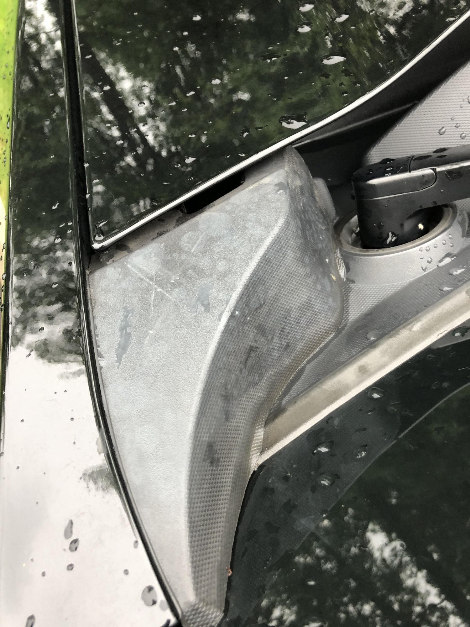

mistermcgoo Posted June 17, 2019 Posted June 17, 2019 When getting in my truck yesterday, I noticed that the plastic/rubber corner piece at the edge of my windshield is faded with water stains. I tried everything to clean it up to no avail. Looks like I may just have to order a new one. To be honest, I have no idea what it’s called and I couldn’t come up with anything after searching around on here. Does anyone know what it’s called? Or have a part number?
MY164X4 Posted June 17, 2019 Posted June 17, 2019 Window cowl I thinkSent from my SM-G930V using Tapatalk
MY164X4 Posted June 17, 2019 Posted June 17, 2019 Or wiper cowl 1 piece set Sent from my SM-G930V using Tapatalk
mistermcgoo Posted June 17, 2019 Author Posted June 17, 2019 24 minutes ago, MY164X4 said: Window cowl I think Sent from my SM-G930V using Tapatalk 23 minutes ago, MY164X4 said: Or wiper cowl 1 piece set Sent from my SM-G930V using Tapatalk Awesome, thanks man!
ammoaddict Posted June 17, 2019 Posted June 17, 2019 Is it the black plastic piece?Sent from my Moto G (4) using Tapatalk
MY164X4 Posted June 17, 2019 Posted June 17, 2019 That what I was thinking also.Sent from my SM-G930V using Tapatalk
mistermcgoo Posted June 17, 2019 Author Posted June 17, 2019 It's the black corner piece. MY164X4 was correct, I found a replacement on Ebay realatively cheap. It's ordered and on the way.. Now I wonder how much of a pain it is to swap out

TRICKsystems Posted June 19, 2019 Posted June 19, 2019 Automotive Glass Tech here, super easy to swap out if you find one. They have two metal retaining clips that go into the fender and a plastic slide into the main cowl. Just pull toward the center of the vehicle and up .
mistermcgoo Posted June 19, 2019 Author Posted June 19, 2019 14 hours ago, TRICKsystems said: Automotive Glass Tech here, super easy to swap out if you find one. They have two metal retaining clips that go into the fender and a plastic slide into the main cowl. Just pull toward the center of the vehicle and up . Awesome, thanks for the tip!
