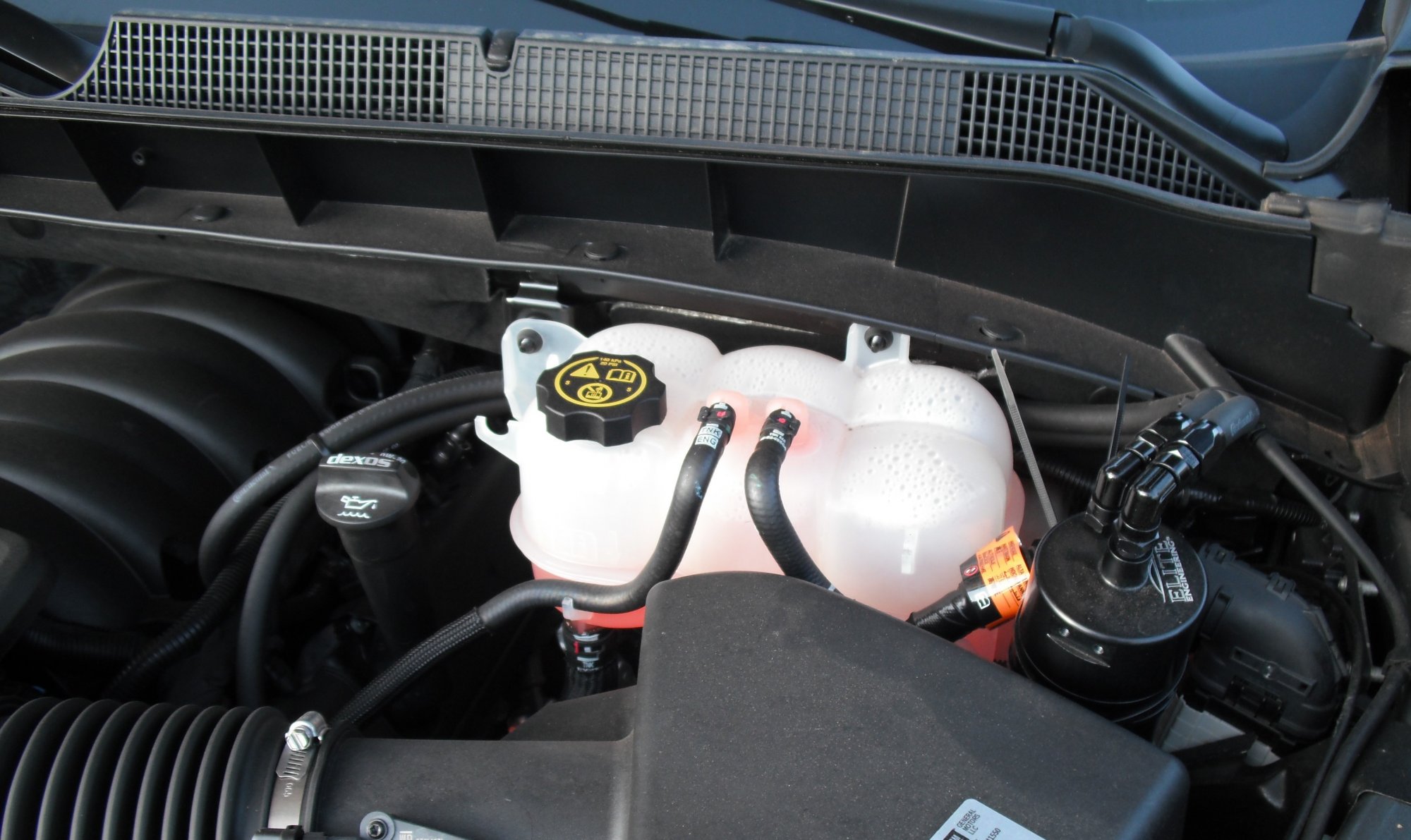

Sorry for the late reply, haven't been on here or some time now but here is a pic of the install. The can isn't mounted with the bracket, I just zip tied it to the wiring harness and fed the hoses behind the coolant reservoir.  She sits solid and I just cut and replace the zip ties when emptying the can. Very convenient and happy with it.

How is access for emptying the can? Just gonna cut the zip tie and put a new one on each time? Probably not the worst considering the layout. Still haven't made the time to try and install mine yet.

Yea, pretty much cut and replace zip ties. I'd actually rather this than a bracket, lots of play when the ties are off and solid when attached. No access issues. I also use 2 zip ties and cross-angle them for stability. The can sits on a metal angled piece so I put a sticky backed rubber piece on it so metal isn't rubbing together. It's almost as if that little space was made for the can ha.
