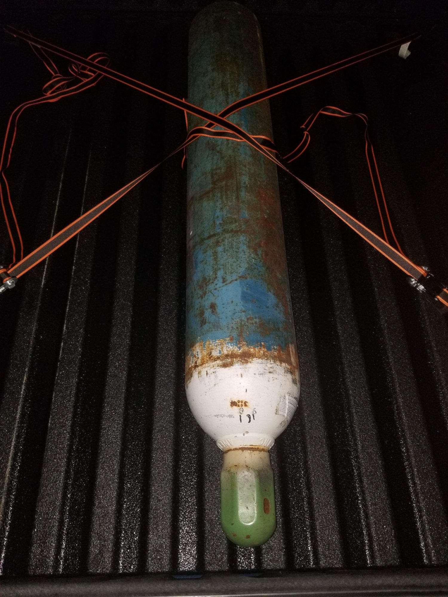

Got my nos ready and everything.  Ok I've been watching too much fast and furious lol.  That was actually a helium tank for my daughter's Bday.
