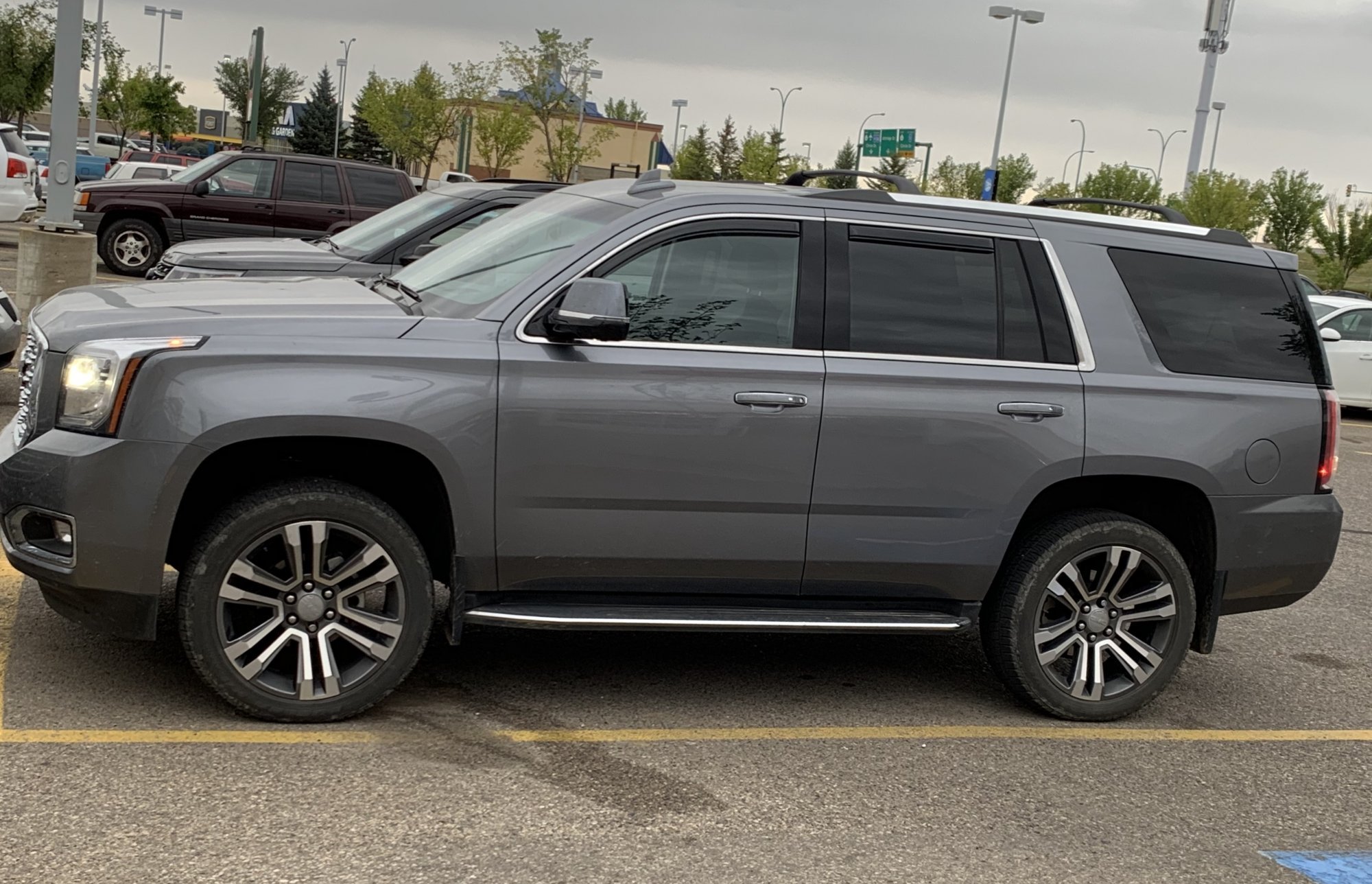

I ended up finding a suspension maxx kit on eBay for a decent price. I installed it at 2” without issue. Here are a couple of pics:

Apologies to revive a 3 year old thread, but throughout my searches I am seeing 1.5" and 2" advertised with no actual measurements provided as per the thickness of the "brick" or spacer.  What would be considered LEVEL with a 2019 Yukon SLT, standard suspension without magnetic suspension or air bag suspension?  1.5" or 2"?  I have asked more than a few eBay vendors what the actual thickness of their spacers is and have yet to hear back.  My next strategy is to buy a couple of spacer kits with FREE RETURNS and measure them myself.  Obviously whatever the measurement of the block is how much the truck would be lifted in the front over the stock rake.
