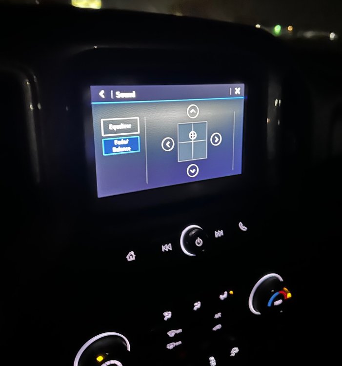

4 hours ago, CT Chevy Connoisseur said:
I used LLJ customs when I did mine.  Plug and play harness and added amp, sub, and upgraded speakers.  Very loud and very clear now.  Only thing that sucks is the factory head unit on work trucks have no balance or fader controls.  Would replace it but upgraded head unit requires IOR stereo that is on-star equipped
I just looked and my W/T has balance and fader control.

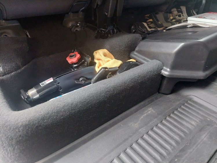

 I just installed the Kicker sub in my '24 HC 2500. I tapped the sub wires right at the front passenger seat instead of the right channel wires as Kicker suggest. I read on a Duramax forum that this was the best option as it gave "2-channel bass", but maybe it's only mono wired from the factory?? You're saying "sswails" says the signal drops to the sub as volume increases?? It made more sense to me to tap into sub power than the right speaker channel. I did buy the sub with the bass control port, but left the factory Kicker "dip switches" set as factory, Switch 1-on, Switches 2 & 3-off. These 3 switches are supposedly the signal outputs. I've also read that if you move all 3 signal dipswitches to on, this improves volume, but another guy suggests that Kickers setting is the best. EVERYONE has their own opinion. I'm going to play with mine a bit as its easy to pull the 4 screws, remove the 200 w amp and access the dipswitch rubber plug cover on the bottom of the amp. This being said, it definitely improved the factory Bose system, but I've NEVER been overly impressed with Bose anything.
I thought I'd post a pic of the factory under-seat storage that I modified to utilize the jack stowage area. Cuts easily with a 4-1/2" grinder & cutting wheel as it's just plastic with glued on fuzzy fabric. The jack stowage bracket has 2-10mm studs w/nuts that hold it in place, which holds that portion of the storage bin in place securely.
