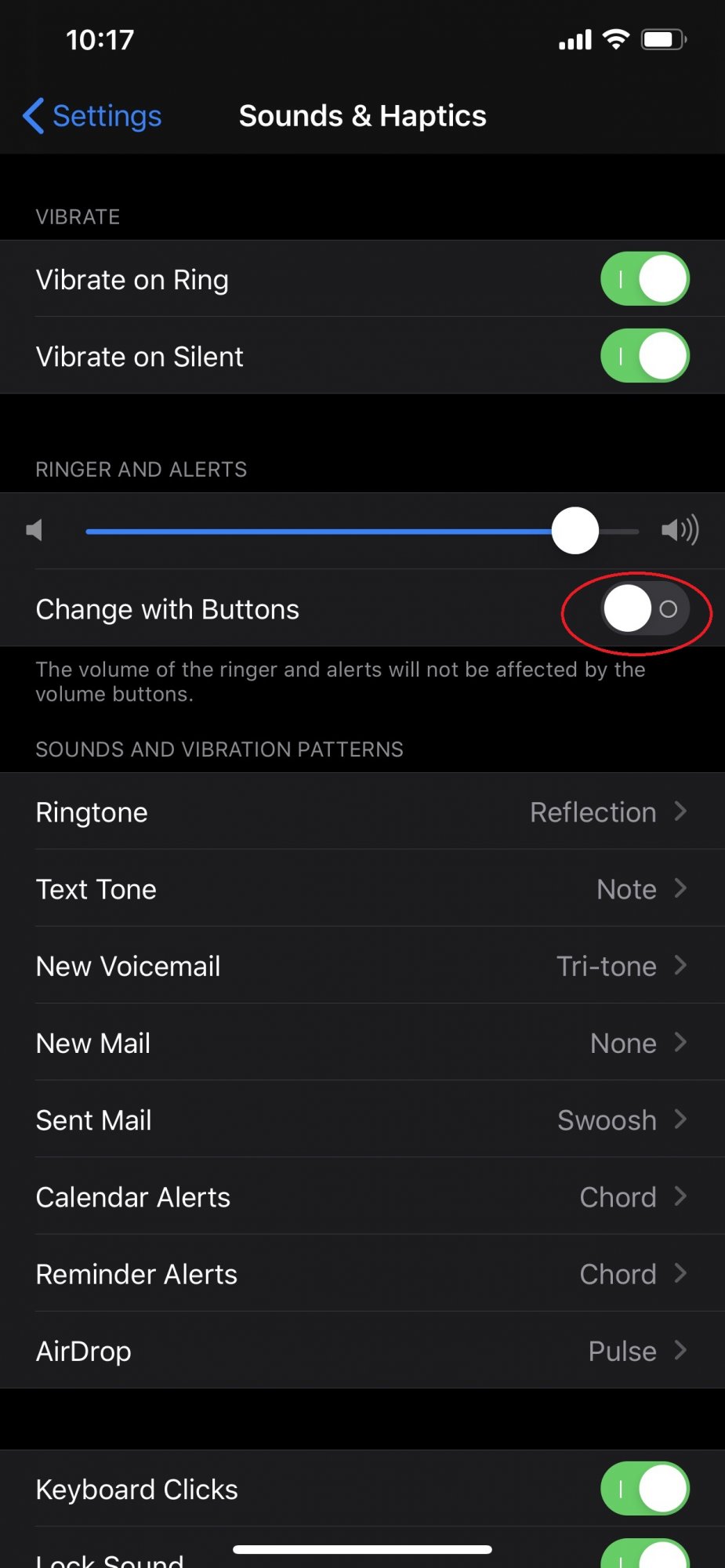

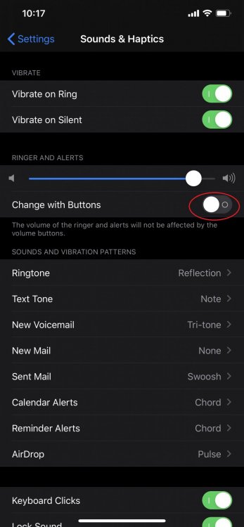

Sorry to bump, but I think I have it figured out for me. . My '16 Sierra and my '18 Terrain do the same thing and it drove me crazy. There's an option on the phone that helped me. Go into settings>sounds. Uncheck the box that says "Change with buttons"
This will stop the car from changing the notification/ringer volume and still allow it to change media volume.
