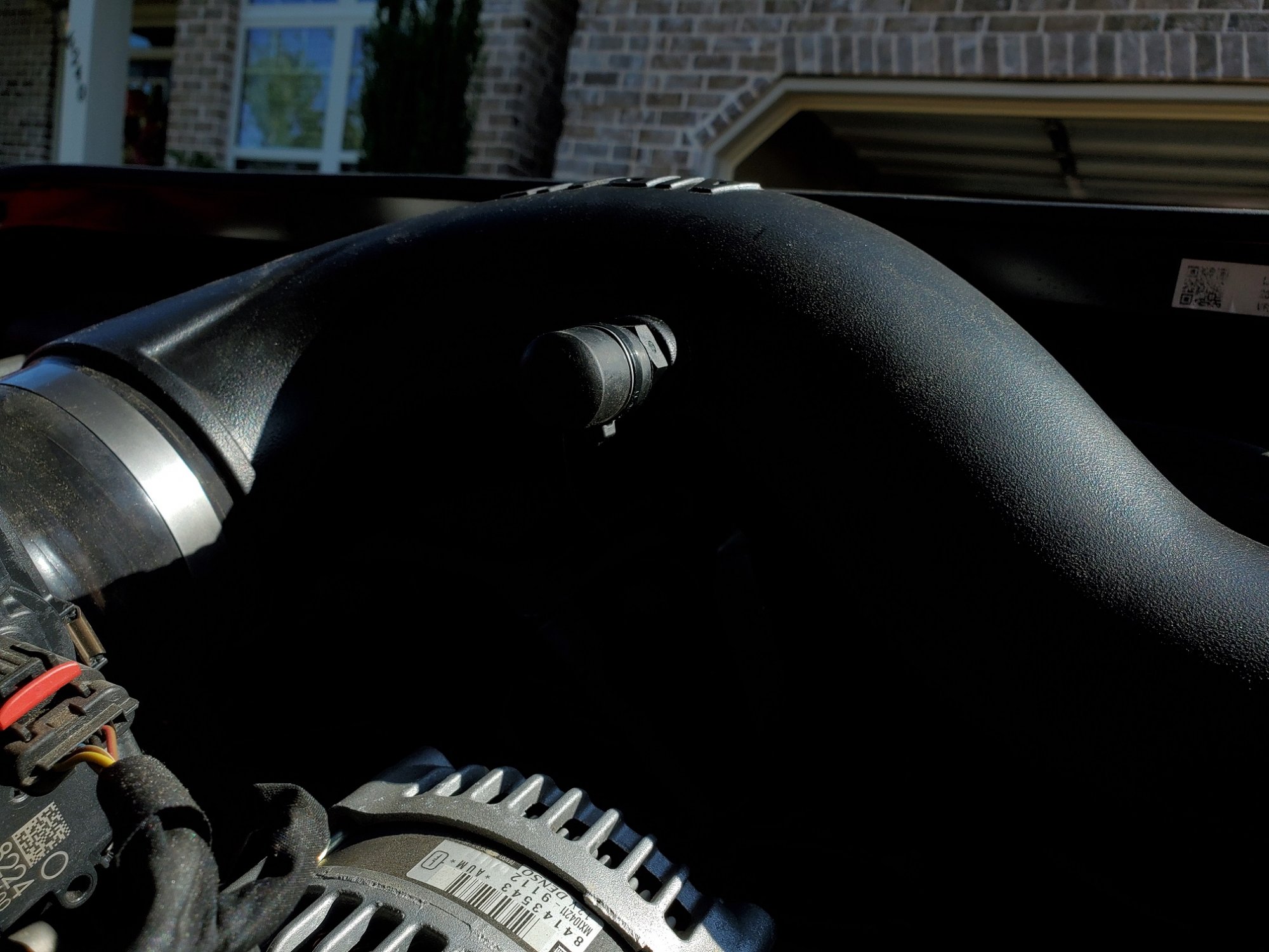

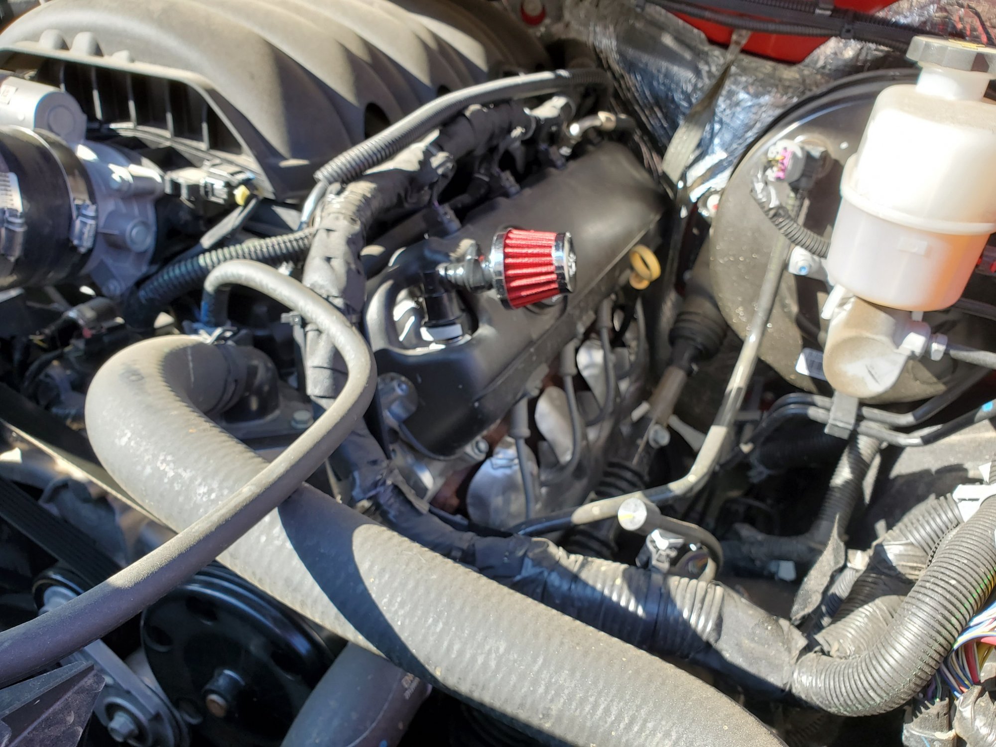

Ok, so here is what I did.  Got the K&N Vent filters, and fitted them right to the click-on vent connectors.  Then removed the hoses going to the intake tube, and capped the openings with rubber caps, and then safety wired them to make sure they don't loosen or go anywhere...  I will drive that way for awhile, see if anything changes...  I can't imagine that I would feel any difference, the question will be if there is any oil that makes it through the filters and onto the motor... So I will be checking for any drips.
My guess is that it won't do that... that the oil we see in the intake normally, is because the system is sucking on that vent tube and drawing it out... that if it was just left to it's own pressure, not much would be coming out at all.
I feel like this is merely an "emissions" thing and that there is no benefit to having it routed to the air intake, and that with GDI motors, it causes more harm.
I only have 19k miles on the truck, so I am hoping that my valves are not too gunked up...  I will have them do the BG Products valve cleaning at my next oil change and I should be good to go, as no new oil is being introduced into the intake.
