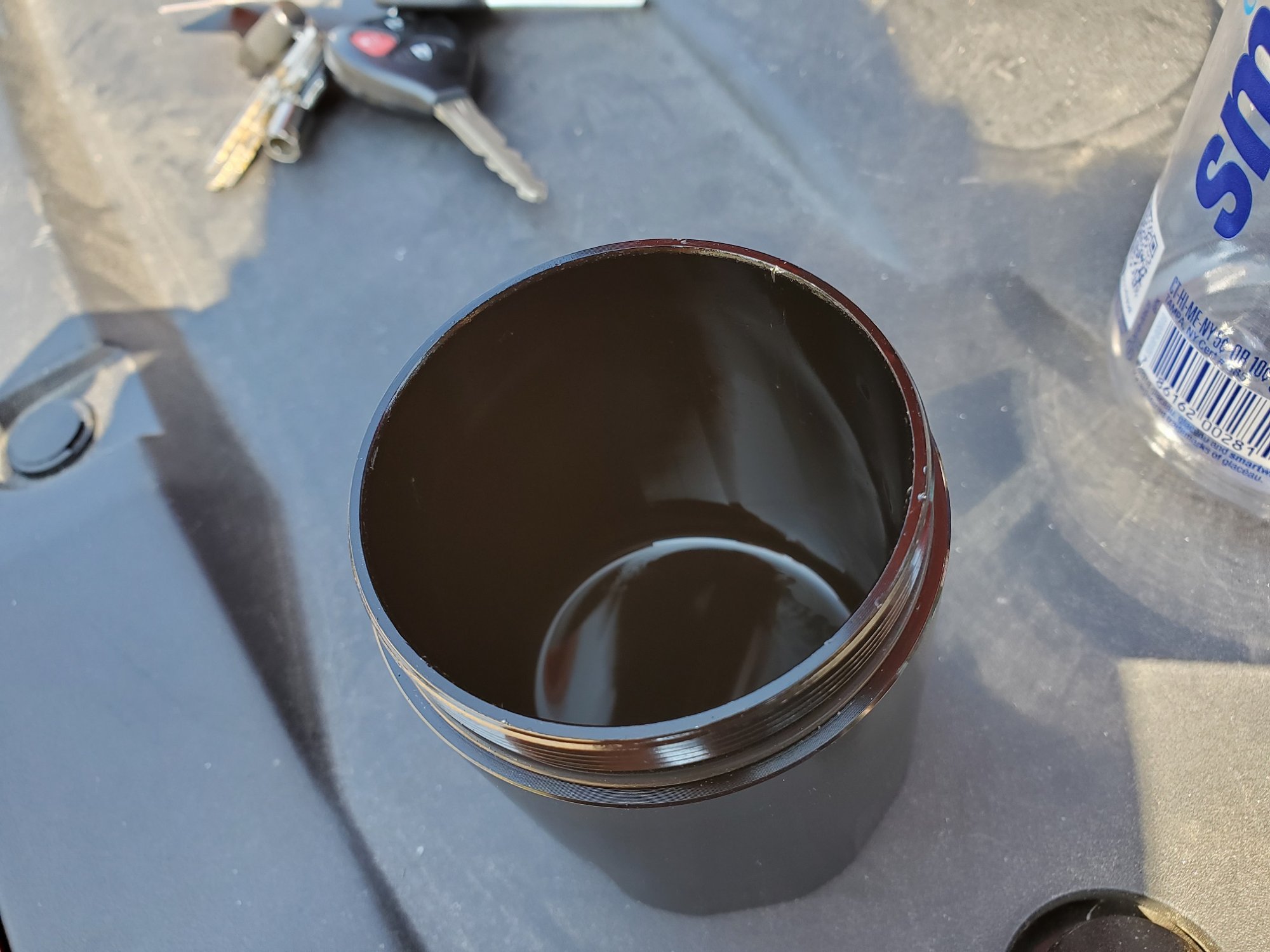

So an update...  Put around 450 miles or so on the truck, give or take.  Pulled the can today to see how much oil was in there, and there was roughly at least half, if not 3/4 of an inch of motor oil in the can... I left it in, and will pour it out and measure it at the 1,000 mile mark.
I also picked up a can of the Seafoam intake cleaner that I plan to do soon, now that I am trapping at least most of the oil from going into the intake...  I would imagine at this rate, by the time I hit 1,000 miles I will have a couple inches of oil in the can...

Here it is after 900 miles.  A couple ounces of dirty oil.  Oil change itself was only 5k miles ago, it's going in on Monday for an oil change and the brake recall...
