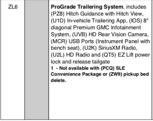

Not sure why, but the fleet guide clearly states that you can not add the Pro Grade Trailering with the SLT Convenience Package:

Order guide says that optional on SLE is:
ZL6         ProGrade Trailering System, includes (PZ8) Hitch Guidance with Hitch View, (U1D) In-vehicle Trailering App, (IOS) 8" diagonal Premium GMC Infotainment System, (UVB) HD Rear Vision Camera, (MCR) USB Ports (Instrument Panel with bench seat), (U2K) SiriusXM with 360L, (U2L) HD Radio and (QT5) EZ Lift power lock and release tailgate
1 - Not available with (PCQ) SLE Convenience Package or (ZW9) pickup bed delete.
Next line in guide shows as standard on SLT/AT4/Denali:
    ProGrade Trailering System, includes (PZ8) Hitch Guidance with Hitch View and (U1D) In-vehicle Trailering App
The SLE Convenience package says:
PCQ         SLE Convenience Package, includes (CJ2) dual climate control, (A2X) 10-way power driver seat including power lumbar, (KA1) heated driver and passenger seats, (KI3) heated steering wheel, (N37) manual tilt/telescoping steering column, (C49) rear-window defogger, (ATH) Keyless Open and Start, (N06) Steering column lock, (BTV) Remote Start, (UTJ) content theft alarm, (AZ3) front 40/20/40 split-bench with underseat storage on Crew Cab and Double Cab models, (USS) 2 charge-only USB ports for second row, (QT5) EZ Lift power lock and release tailgate, (UF2) cargo bed LED lighting, (KPA) rear auxiliary 12-volt power outlet, (T3U) fog lights, (U01) Roof Marker Lamps and (B1J) rear wheelhouse liners
1 - Included with (PDU) SLE Value Package. Not available with (B59) Remote Start Package. Not available with (ZW9) pickup bed delete. Note (U01) Roof Marker Lamps are not available with (YF5) California state emissions requirements. Note: (AZ3) front 40/20/40 split-bench with underseat storage on Crew Cab and Double Cab models can be upgraded to (A50) bucket seats with (D07) center console.

As I suspected, the Prograde Trailering package appears to be unavailable to lowly SLE pilots.
