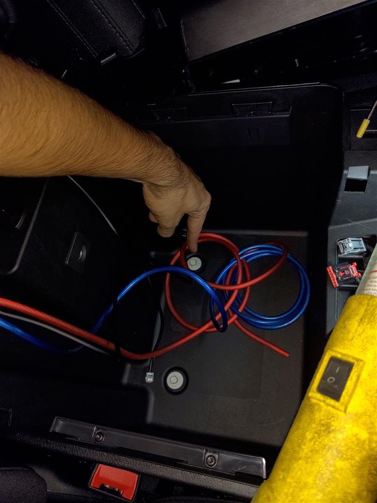

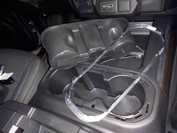

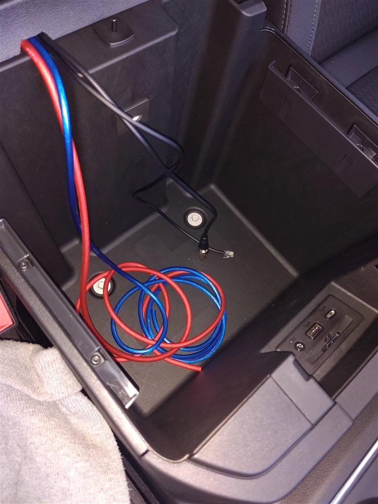

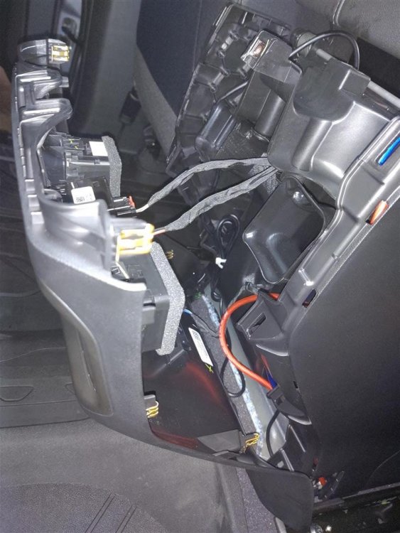

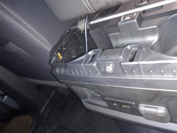

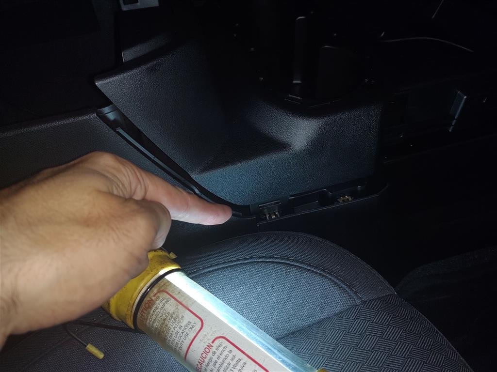

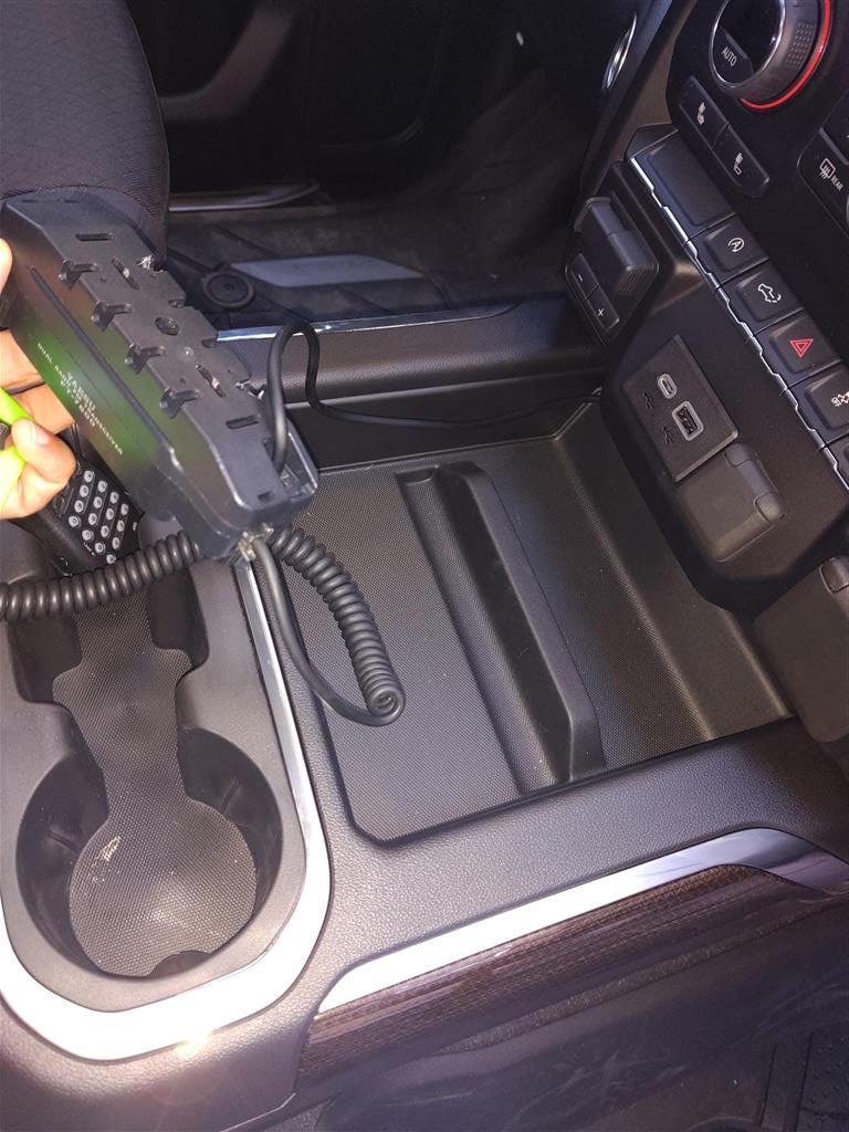

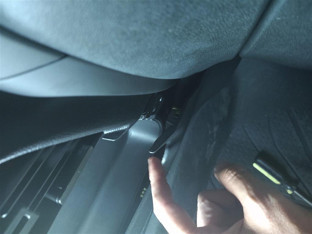

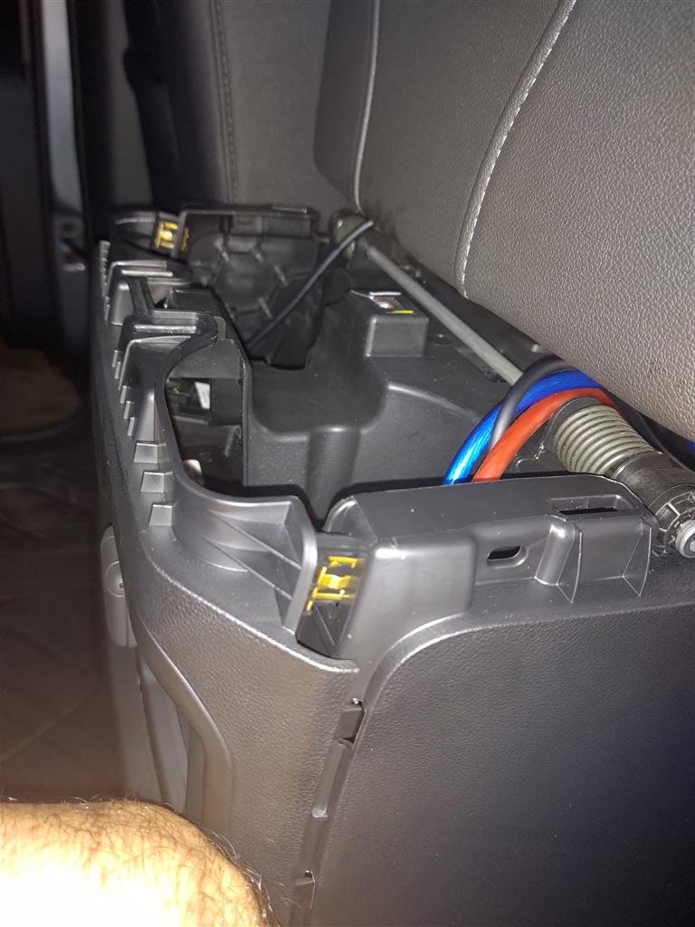

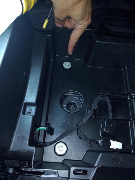

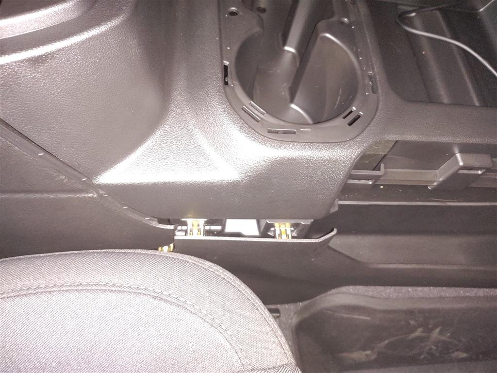

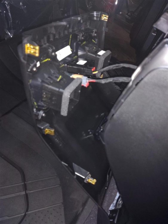

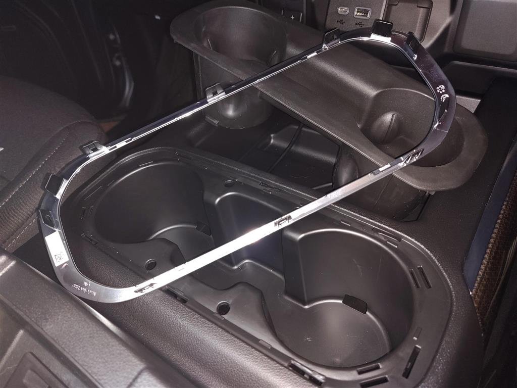

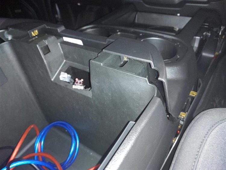

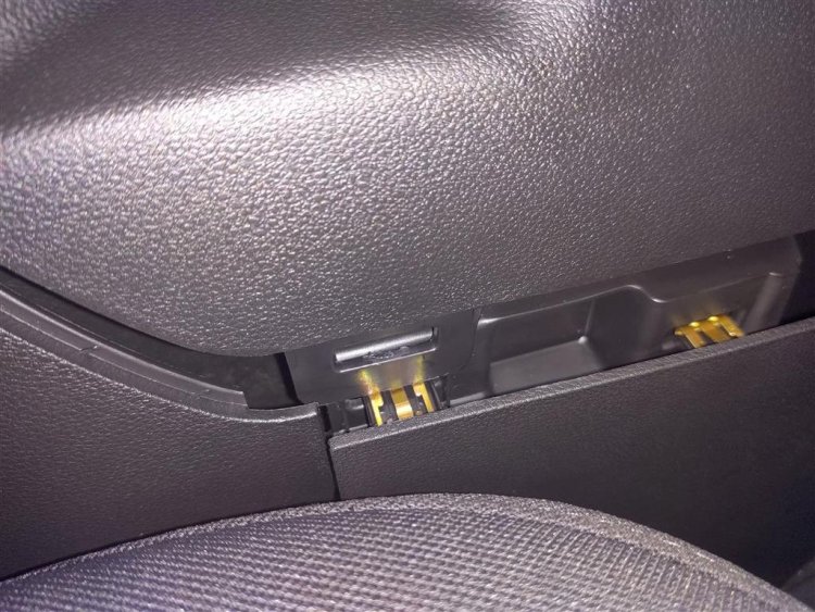

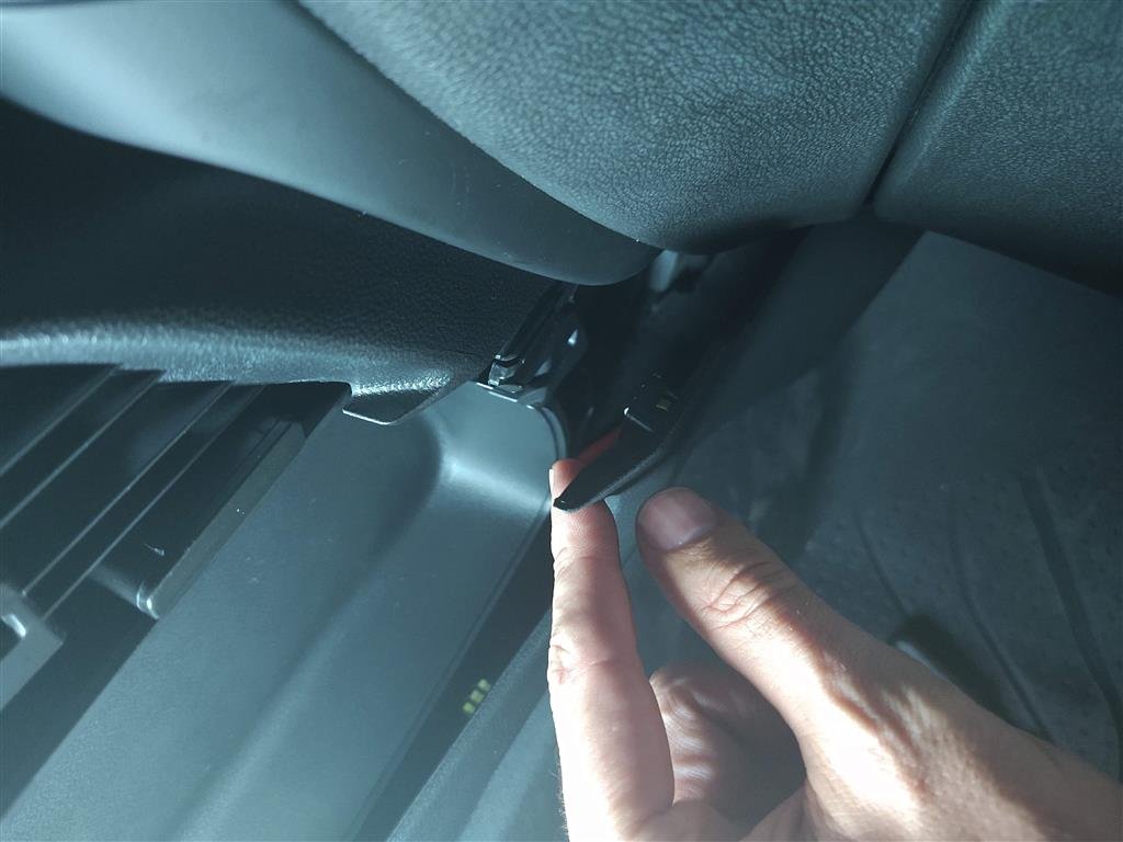

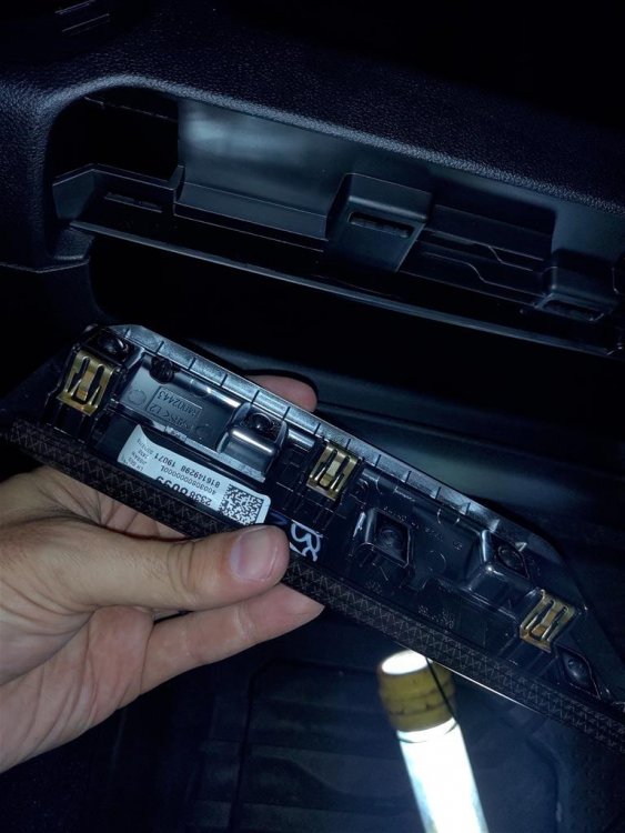

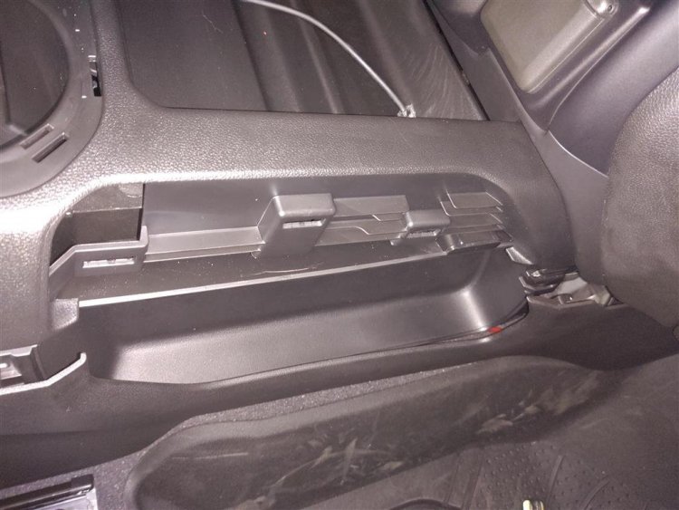

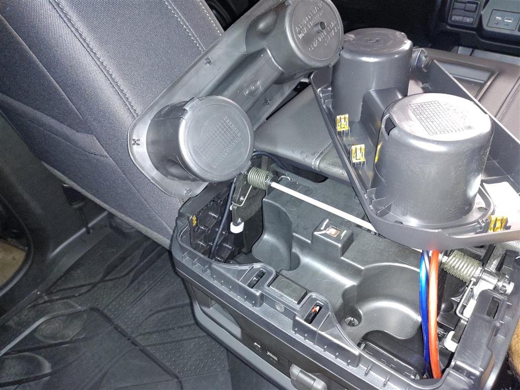

Thought I would share some photos of my partial console tear-down. This are not in any order. I did not fully pull out the console as I didnt need to do so to finish my install. The most important part to know is the console has side "plates" on it. These need popped loose first before you try and pop up the middle/center of the console.
Also, there is absolutely no reason to pop off the chrome trim plates. They dont hold anything down or expose other clips. I broke a couple on mine (it brok the clips on the inside of the console and not the trim) and it bows a little now. I will likely glue it back.
If someone wanted to take these and post further pics, this would be a good start.
This is a RST with Convenience Package 2.
